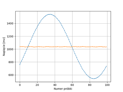

I tested the configuration by measuring 100Hz sinusoidal signal made with a function generator at different sampling frequencies. The sampling frequency value was set to 10000Hz in iio user space as displayed in iio_info (important later):
attr 0: sampling_frequency value: 10000
The signal was measured with the iio_readdev | hexdump command and ploted on a graph 
Blue is 100Hz, 1Vpp amplitude, 1V DC offset sine (ignore orange).
The sine looks good and it takes 10kHz/100Hz=100 samples to display a full sine period, so everything works correctly.

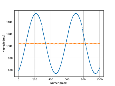

The sampling rate was then set to 100kHz (which should be achievable) and the same 100Hz signal was measured. While setting the frequency, a weird iio_info output was observed (set frequency 100037 instead of 100000):
attr 0: sampling_frequency value: 100037
While measuring and plotting with with the iio_readdev | hexdump the iio library returned this message:
WARNING: High-speed mode not enabled
In the correct signal, one sine period should take 100Khz/100Hz=1000 samples. Here, it takes around 500 so it's around 50kHz. The other problem of my approach is the visible sample skipping artifacts (for example around 800th sample).

My question is how can i solve this issue? I imagine this low sample rate limit is caused by some performance bottleneck somewhere in the reading of my buffer. Is it because the iio driver isnt actually using dma to transfer samples like explained here?
https://ez.analog.com/linux-software-drivers/f/q-a/561766/warning-high-speed-mode-not-enabled
Could someone please hint me how can I enable high speed mode or increase the drivers performance? I tried to upgrade my IIO driver from 0.15 > 0.21 the issue with sample skipping was less present but the frequency limit was still there. I also tried to use the library with python wrapper with no effect. Maybe i need to upgrade of my OpenSTLinux kernel or the dma has to be configured differently in the devicetree? Thanks in advance.
