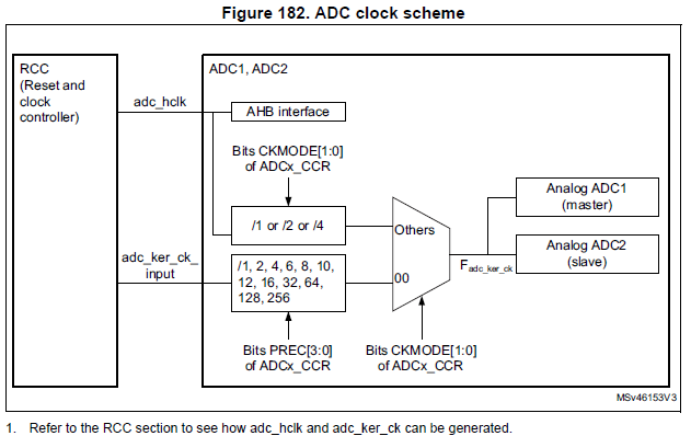

STM32MP157A M4, the result of ADC_1 always is odd value. (the DR LSB is '1' always.)
fctu
I'm porting ADC on M4, but some how the converting result is odd value always, seems the DR bit-0 is always '1'.
I tested it by VR, range from 0v to 3.3v, the ADC suppose to convert it from 0 to 255, but I don't know why, I just get odd value back, like 1, 3,5....197,199,201....255. No even number at all.

Please check if your other platform settings are fulfilling the ADC characteristics of datasheet, especially ADC maximum operating frequency of 20MHz (or 36MHz with BOOST=1).0693W000004GgvbQAC.png
