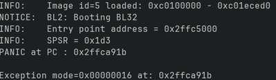

I was trying to change STGEN access mode from secure to non-secure mode in ETZPC properties, in tf-a device tree, but at startup system is always in PANIC like here:

Without more debug information, the TF-A log is a bit hard to speculate from.
