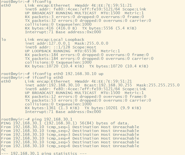

With the log you shared, we did not see any issue with the Ethernet, you end up at [12.232391] with a 'link-up' message.
Issue might be more on your Network Server set up. Seems you get an ipv6 address without ipv4, then you need to set manually an ipv4 address. Please look at your DHCP server config.
Did you made same tests using STM32MP157A-DK1 or STM32MP157C- DK2 board with default starter package ?

On my side, I cannot help much more, experts told me that it could be a DHCP or your own network config which make the ping not working.
There is no error visible in the log.

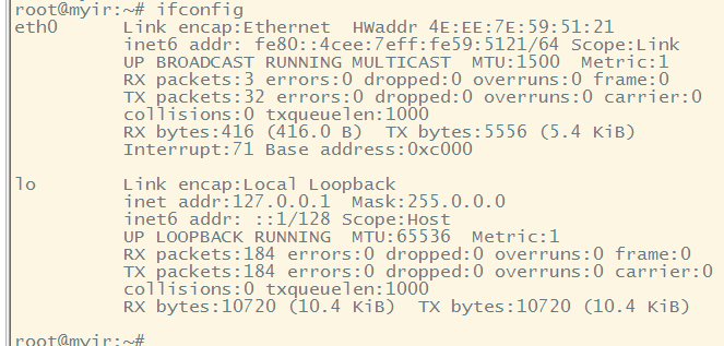

When doing ifconfig after boot and few seconds after RJ45 cable connection, you should have both inet and inet6 defined without manual action, e.g. :
root@stm32mp1-eval:~#  ifconfig
 eth0            Link encap:Ethernet HWaddr 00:80:E1:01:64:F9
                inet addr:10.48.0.89 Bcast:10.48.3.255 Mask:255.255.252.0  <== here
                inet6 addr: fe80::280:e1ff:fe01:64f9/64 Scope:Link  <== here
                UP BROADCAST RUNNING MULTICAST MTU:1500 Metric:1
                RX packets:68 errors:0 dropped:3 overruns:0 frame:0
                TX packets:47 errors:0 dropped:0 overruns:0 carrier:0
                collisions:0 txqueuelen:1000
                RX bytes:10311 (10.0 KiB) TX bytes:9222 (9.0 KiB)
                Interrupt:60

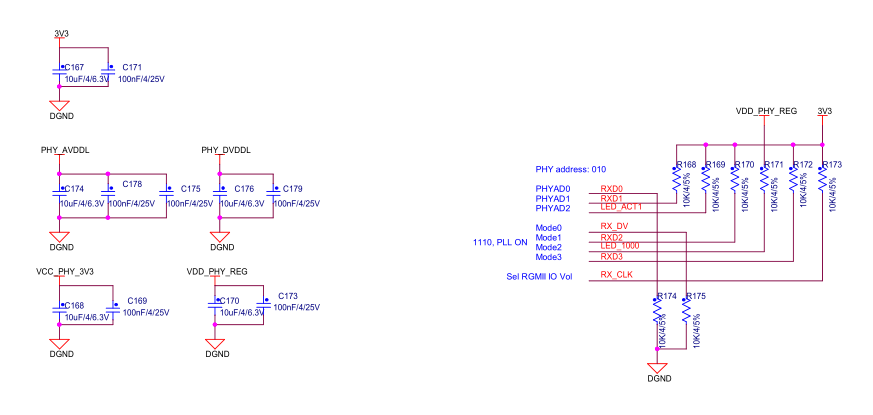

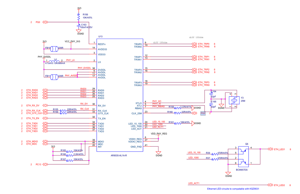

Can you help me check the hardware design of the phy
The phy address is 6
I had a quick look, just ensure the PG5 receive a 125MHz from the PHY (need SW config inside the PHY to output this frequency, otherwise you get 25MHz by default on CLK_25M pin).
Tip of the day: Try Sidekick STM32 AI agent, see here
Yes, it needs to be configured to 125M in the PHY driver, otherwise the default is 25M, thank you.

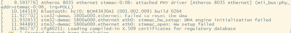

​Thank you very much for your support, but I found a bug. I added the operation of configuring 125MHZ in the PHY driver, and found that the connection with the router could be normal, but the failure of initializing the dma if the network cable is not connected will result in failure. I measured the existence of 125MHZ in PG5.
VRoma.2
AR8035 switches RX clock off without a cable or after some time passed.
How to reset gmac dma in absence of that clock?
Is there any official workaround for such a situation?
