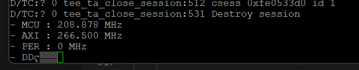

I Also have a this problem where u-boot stops at the clock 151. On thing worth to note that for me if I turn off debug printing Linux will boot just fine so u-boot must somehow run but it stops printing around the DDR frequency printing. So we are able to use the system but it's more or less a requirement that we should be able to enter u-boot.
optee optee: OP-TEE: revision 3.19 (afacf356)                                                                                                                Clocks:
- MPU : 650 MHz
- MCU : 64 MHz
- AXI : 133 MHz
- PER : 64 MHz
- DDR ��M&&j!�5

I have the exact same problem as well, it stops u-boot uart at - DDR  (some times bad characters comes her so it seems the UART is abruptly stopped) and if I enable debugging it stops at enabling clock 151. One thing worth noting is that it seems to be the u-boot console that is not working, Linux boots just fine as long as i disable the debug log. I would like to acces the uboot console so I would be very interested in what this known bug in the ECO is, is there a place where these known bugs are written down???

Hi, I just encountered the same issue, "stops u-boot uart at - DDR (some times bad characters comes her so it seems the UART is abruptly stopped) ", and sadly blocked here for several days after trying many different methods..can you share how you fix the problem? Many thanks for that. And one more question, using the default working stream, do you know where to insert the macro like CONFIG_LOG_MAX_LEVEL=7? Now I have to use the git and create patch file to replace the one appeared in the layer of meta-st, really cost huge amount of time. Thanks20240216224716.png
