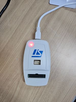

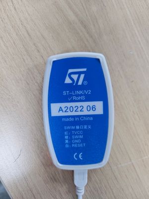

Please provide photos of your ST-LINK/V2 from the rear and front.
Regards
/Peter
Thank you for your response.
Due to an issue with the browser I was using, the language was incorrectly recorded, so I have corrected it to English.
The photo below shows what I have
Regards
SL1
Peter BENSCH
Such connection problems have often been discussed here in the community and in most cases this is due to cheap but unsupported clones from unauthorised dealers. Your ST-LINK/V2 is most likely an illegal clone with a fake STM32F103 and is therefore not recognised as a valid debug tool (see also this Knowledge Base article).

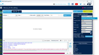

Upon checking, the serial number appears to be a single digit (Programmer).
Since the case and appearance are identical, I thought it was a genuine product.

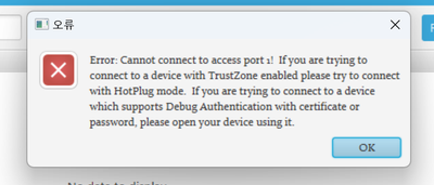

Therefore, I searched for a genuine product and attempted to connect it, but the connection failed
We are using the MP131FAE7 CPU and have set up the debug line as follows
PF14 : SWCLK
PF15 : SWDIO
PH4 : SWO
NJTRST, NRST
We have connected NJTRST and NRST according to the CPU pins.
Could you please provide a solution to this issue?
Additionally, Is it possible to debug this CPU with the V2 version?
Hi @SL1
you can debug the STM32MP1x family using ST-Link V2.
https://wiki.st.com/stm32mpu/wiki/STM32MP1_Platform_trace_and_debug_environment_overview
But you can't connect to STM32MP1 using CubeProgrammer with SWD/JTAG.
Flashing of MPU products must be done using USB (OTG port for STM32MP1 family).
https://wiki.st.com/stm32mpu/wiki/STM32CubeProgrammer
