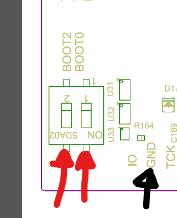

I got confirmation that it is working like I explained. TF-A device tree is enough.
Was double checked on ecosystems v3.0 and v3.1.
On DK1/DK2 board, you could check VDD shutdown on one of the BOOT switches with a voltmeter (GND point available next to it).
0693W00000JOMUMQA5.pngRegards.
