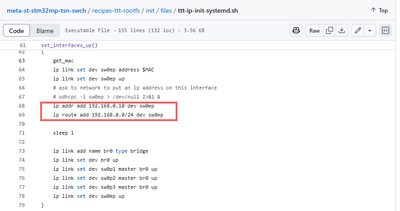

Can I only modify the ttt-ip-init-systemd.sh script if I need to change and persist the IP address while using the STM32MP switch mode?
4 REPLIES 4
Bernard PUEL
YEs the script is there for that so you can customize it for your setup or product !
Can I use the service in Systemd to set it up?
Of course you can.
As soon as the switch driver is probed, the configuration is done by Kernel standard interfaces.
