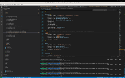

I carefully checked the dts and found the spi3 was not enabled.
But after I enabled the spi3(line 754), the spi bus can't be probed.
root@stm32mp2:~# dmesg | grep spi
[    0.274005] stm32-sys-bus 42080000.rifsc: spi@400c0000: Peripheral will not be probed
So how to enable spi3 in stm32mp257f-ev1?
even I didn't enable the spi3, the SPI3_SCLK(PB7)/SPI3_MOSI(PB8)/SPI3_MISO(PB10) has been already occupied.
but I in deed can't found which one has used the pins.
