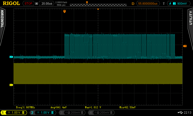

Openocd polls MP1 every 100ms by 2 SWD register reads (blue), MCOs are stable (yellow):

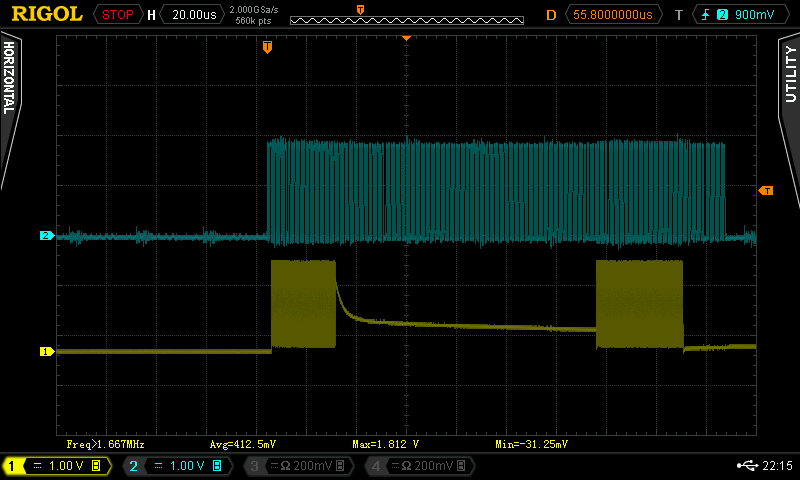

It seems the same as before (it should). But wait, what is this:
MCO outputs are no longer there, when MPU is in halt ! Even more interesting is,
outputs are on every 100ms - each SWD register read turns GPIOs back on for a while but then they are off again.
