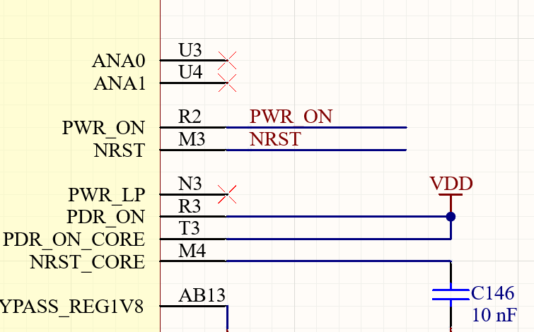

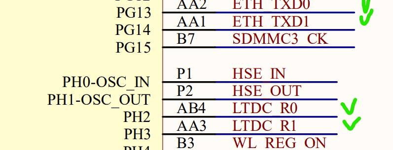

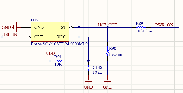

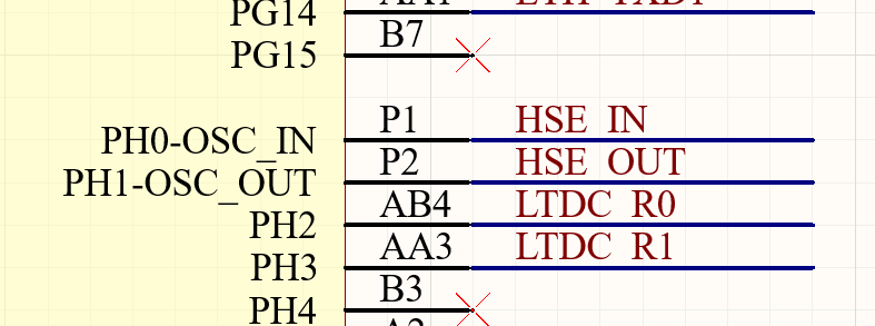

Hi @PatrickF
Can you explain why my PWR_ON won't have any actions in my schematic?
This is from my board.
Skärmbild 2024-05-07 203348.pngSkärmbild 2024-05-07 203233.pngSkärmbild 2024-05-07 203200.png

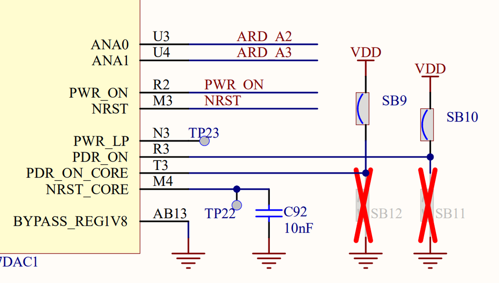

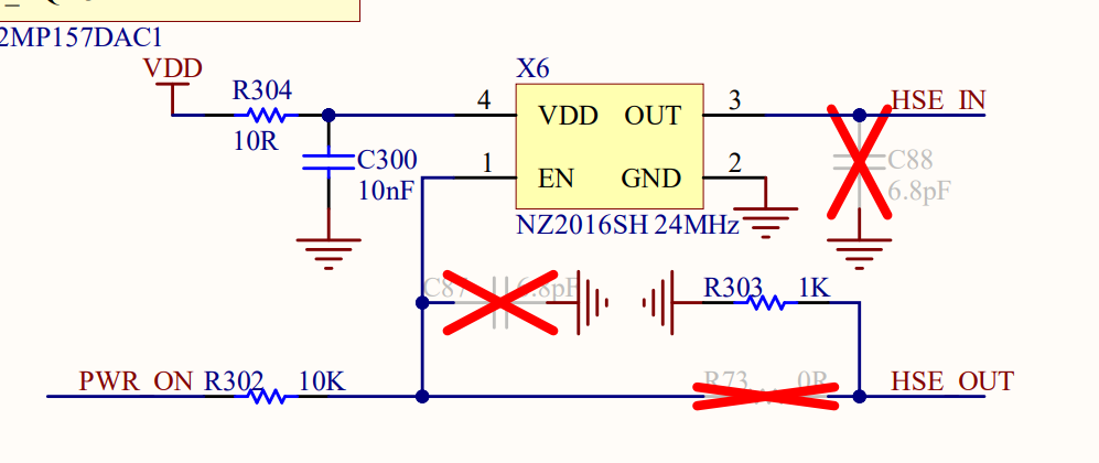

This is from the dev-kit. I assume that the zero-ohm resistor should be removed and replaced with a track only. But the capacitors should not be replaced with a track.
Skärmbild 2024-05-07 203521.pngSkärmbild 2024-05-07 203505.pngSkärmbild 2024-05-07 203448.png
