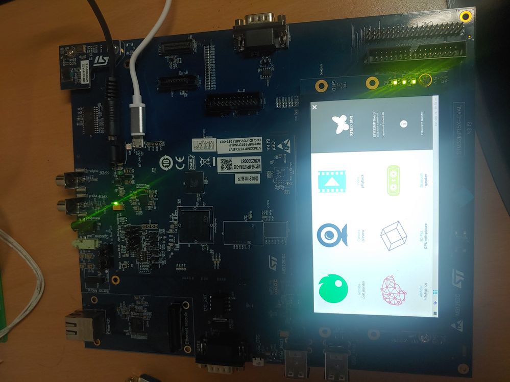

How to get terminal on STM32MP157D-EV1? The COM port cann't be seen from the host PC.
HKim.23
The board is set up as follows, and USB of ST-Link V2-1 is connected to Host PC.
when using Linux host pc , /dev/ATM* devices not recognized.
So I used a Windows PC, but it is not recognized either.
Do I need to install a special driver to recognize the Uart serial?
Or is there a problem with the Jumper setting?

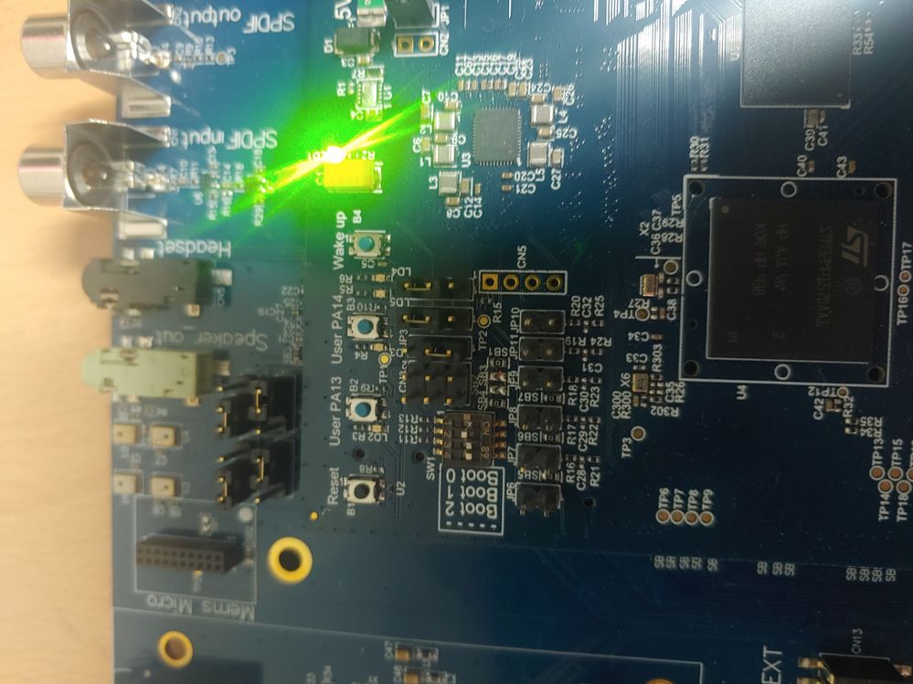

I set the jumpers same (JP1 removed, JP4[2-3], JP5[2-3]). However, when I connect the USB cable from CN4(ST-Link V2-1) to PC, the results are still same as yours. (Linux host pc: /dev/ttyACM* devices not recognized. Windows PC: the USB is not recognized either.) Do I need any other driver or accessory for this?
Thanks.
what is the status of LD6 ?
Check your USB cable, there is some USB cables (provided with cheap gadgets) which does not have USB data connected (only VBUS wires) !
Regards.

LD6 should be at least green + red very low bright (or light green or red) as soon as STLINK 3.3V supply is present (either 5V using Jack or STLINK VBUS)

Sorry. LD6 shows very low bright(green+red). I didn't feel it before.
I installed stsw-link009 before. I don't see any improvement with it.
I never saw STLINK working so far. I don't connect CN6. I downloaded the starter package through CN16 OTG only. HW changes I made are the jumpers(stated above) and SW1(sd boot).

Maybe double check if JP1 is not present.
https://wiki.st.com/stm32mpu/wiki/Getting_started/STM32MP1_boards/STM32MP157x-EV1/Let%27s_start/Unpack_the_STM32MP157x-EV1_board
Regards.
Tip of the day: Try Sidekick STM32 AI agent, see here
Sure. As I mentioned on the first question, JP1 jumper is surely removed.
