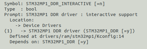

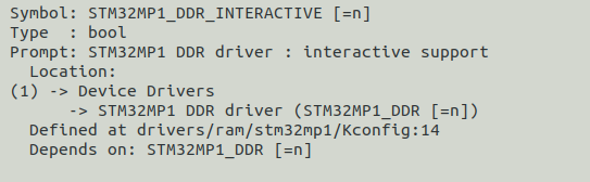

CONFIG_STM32MP1_DDR_INTERACTIVE is not the easiest configuration to enable because it implies to have already enabled other configurations.
The first things to do is search “DDR_INTERACTIVE�?. To realize a search in the menuconfig, you have to hit “/�? key and type the text that you search.
A window like this appears:
As you can see, “STM32MP1_DDR�? is set to [=n] because you have to enable “STM32MP1_DDR�? before being able to enable DDR_INTERACTIVE.

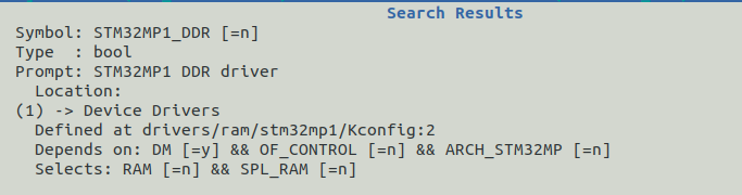

So search “STM32MP1_DDR�? .
0693W00000HoWwyQAF.pngYou see that you have to enable "OF_CONTROL" and "ARCH_STM32MP" before enabling your configuration

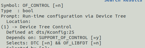

So one more search, search for “OF_CONTROL�?
You can hit the key “1�? to directly go where the config is located or you can search it inside "-> Device Tree Control"
Enable the configuration.

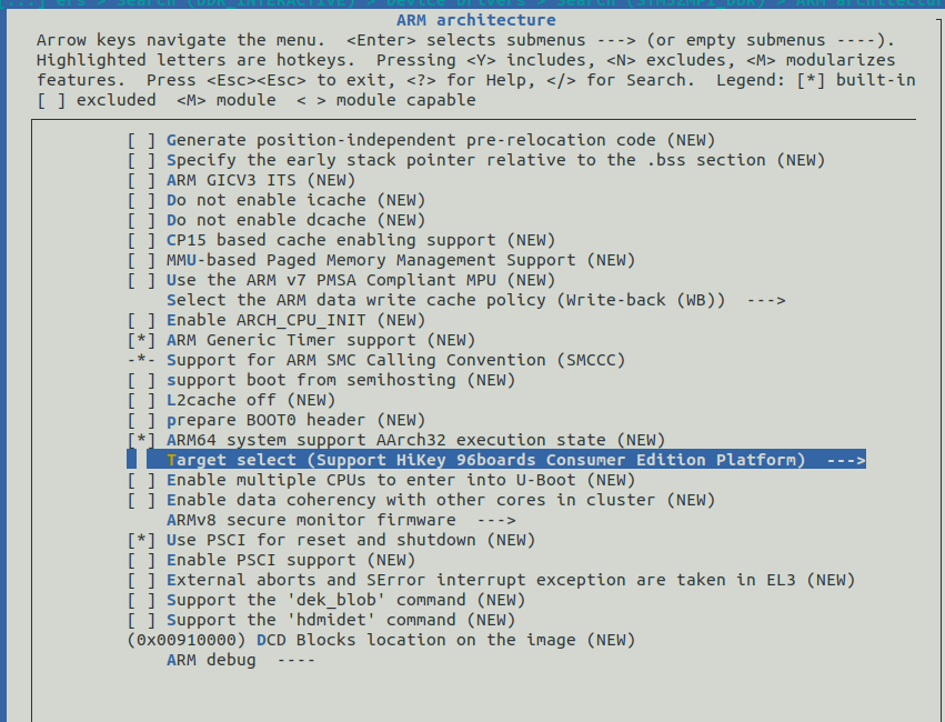

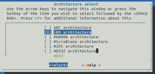

Then to enable "ARCH_STM32MP", you have to change the architecture type from Sandbox to ARM.
This can be done at the root of the menu:
Select ARM architecture in the list.

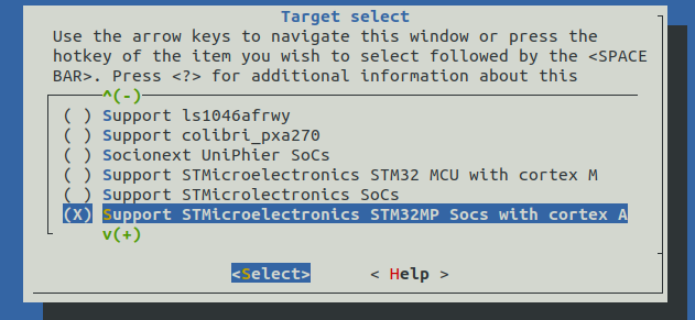

Now, a new menu appears “ARM Architecture�?. Go inside and looks at “Target select�?.
0693W00000HoX0HQAV.png Modify it to select “Support STMicroelectonics STM32MP Socs with cortex A�?

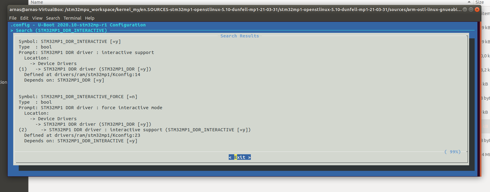

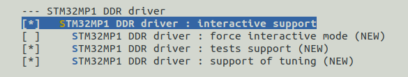

Finally, you can search again “DDR_INTERACTIVE�? and you will see that you enabled the needed “STM32MP1_DDR�? !
0693W00000HoX1KQAV.pngHit the key “1�? to go directly in the correct submenu or go in:
Location:                                                                               â”‚
 â”‚    -> Device Drivers                                                                     â”‚
    â”‚      -> STM32MP1 DDR driver (STM32MP1_DDR [=y])
And enable it.
The CONFIG_STM32MP1_DDR_INTERACTIVE configuration is now activated.

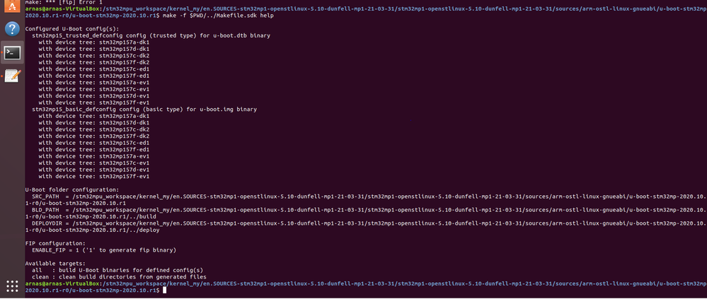

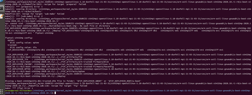

0693W00000HoYYFQA3.pngso after making the configuration changes, I tried to follow the "README_HOW_TO.txt" - 5.2 Compilation for several targets: use Makefile.sdk (with FIP). But ran into some issues when trying to create an image with "make -f $PWD/../Makefile.sdk all"
>>make -f $PWD/../Makefile.sdk help
>>export FIP_DEPLOYDIR_ROOT=$PWD/../../FIP_artifacts
Missing u-boot-stm32mp157a-dk1-trusted.dtb file in folder: '$FIP_DEPLOYDIR_UBOOT' or '$FIP_DEPLOYDIR_ROOT/u-boot'
/stm32mpu_workspace/kernel_my/en.SOURCES-stm32mp1-openstlinux-5.10-dunfell-mp1-21-03-31/stm32mp1-openstlinux-5.10-dunfell-mp1-21-03-31/sources/arm-ostl-linux-gnueabi/u-boot-stm32mp-2020.10.r1-r0/u-boot-stm32mp-2020.10.r1/../Makefile.sdk:136: recipe for target 'fip' failed
make: *** [fip] Error 1
0693W00000HoYe8QAF.png0693W00000HoYemQAF.pngecho $FIP_DEPLOYDIR_ROOT/u-boot
/stm32mpu_workspace/kernel_my/en.SOURCES-stm32mp1-openstlinux-5.10-dunfell-mp1-21-03-31/stm32mp1-openstlinux-5.10-dunfell-mp1-21-03-31/sources/arm-ostl-linux-gnueabi/u-boot-stm32mp-2020.10.r1-r0/u-boot-stm32mp-2020.10.r1/../../FIP_artifacts/u-boot
/stm32mpu_workspace/kernel_my/en.SOURCES-stm32mp1-openstlinux-5.10-dunfell-mp1-21-03-31/stm32mp1-openstlinux-5.10-dunfell-mp1-21-03-31/sources/arm-ostl-linux-gnueabi/FIP_artifacts/u-boot$ ls
u-boot-nodtb-stm32mp15.bin     u-boot-stm32mp157d-dk1-trusted.dtb
u-boot-stm32mp157a-dk1-trusted.dtb u-boot-stm32mp157d-ev1-trusted.dtb
u-boot-stm32mp157a-ev1-trusted.dtb u-boot-stm32mp157f-dk2-trusted.dtb
u-boot-stm32mp157c-dk2-trusted.dtb u-boot-stm32mp157f-ed1-trusted.dtb
u-boot-stm32mp157c-ed1-trusted.dtb u-boot-stm32mp157f-ev1-trusted.dtb
u-boot-stm32mp157c-ev1-trusted.dtb
$FIP_DEPLOYDIR_UBOOT - is empty
did i miss something? :D

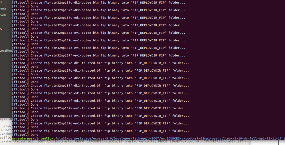

I have cleaned the project and started all over using the TF-A. And I believe i managed to build FIP according to my changes. My mistake was that when following README.HOW_TO.txt i was following "5.1 Compilation for one target (one defconfig, one device tree) - and no FIP" when I should have been using the "5.2 Compilation for several targets: use Makefile.sdk (with FIP)" because I have TF-A installed - atleast my this is my guess :D
_legacyfs_online_stmicro_images_0693W00000HogFV.pngso now I have successfully have generated all versions of ***.bin and ***.dtb (example: u-boot-stm32mp157c-dk2-trusted.dtb and fip-stm32mp157c-dk2-trusted.bin) files according to "myboot.config" content. Atleast I am guessing they follow my config file - no way to know untill I upload them right?
What should be the next step now, how should i upload them them now? Thanks! :)
Hi @Arnas Celkys​ ,
Yes it seems ok now, but next time, you can specify the TF_A_DEVICETREE to only generate the needed fip for your board.
I advise you to follow the How to cross-compile with the Developer Package wiki page and especially the parts on U-Boot and TF-A. It is explained how to copy the binaries on the board using ums 0 mmc 0:
https://wiki.st.com/stm32mpu/wiki/How_to_cross-compile_with_the_Developer_Package#Modifying_the_U-Boot
Regards,
Kevin
