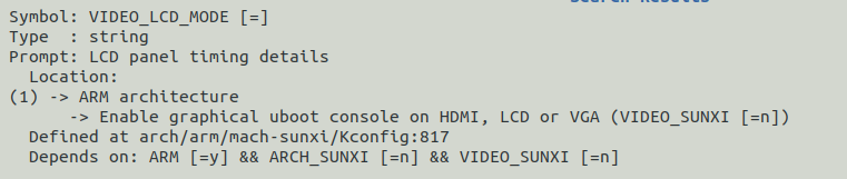

We are using stm32mp157a processor in my custom board.In my custom board we have limited peripherals so i need to disable remaining peripherals like ltdc and hdmi ,etc. I disabled in dts files but it didn't effected. How can i disable peripherals in u boot?

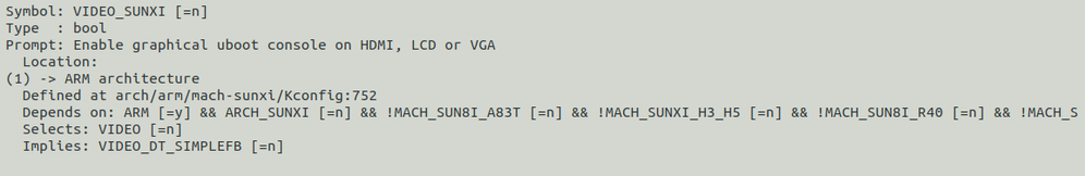

But regarding your first request about "ltdc and hdmi", I don't understand because normally the driver related to HDMI is already disabled on U-Boot.
The configuration that enables the hdmi video driver is VIDEO_SUNXI, which is disabled by default:
And the configuration which allows to choose to use the HDMI is CONFIG_LCD_MODE :

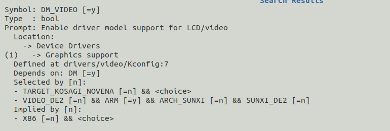

Maybe you are talking about the support of the DSI peripheral, in this case you can disable it by disabling DM_VIDEO :
0693W00000JO4nkQAD.pngIf this configuration is disable, the compelte driver model to support video will be disabled, even the splash screen of u-boot will be turned off.
