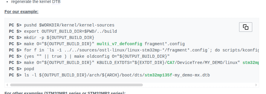

PatrickF
November 7, 2025
Hi @jumman_JHINGA
I'm not expert in SW, but did you update both uBoot and Kernel DTS similarly ?
see also https://wiki.st.com/stm32mpu/wiki/How_to_compile_the_device_tree_with_the_Developer_Package
Regards.
