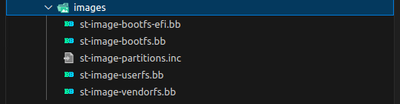

Is this method the same as modifying on the generated tsv? I am wondering if there is a quick way to define new partitions in Yocto, such as rootfs, userfs, etc。
Hello @bugman,
These recipes are there to cook the content of the partitions, not to add a new partition.
BR,
Christophe
Thank you very much for your patient reply.
Perhaps my initial statement was not correct.
My goal is to create a new partition with my own custom content, so I tried to create recipes but encountered many problems. I wonder if my direction is incorrect?
