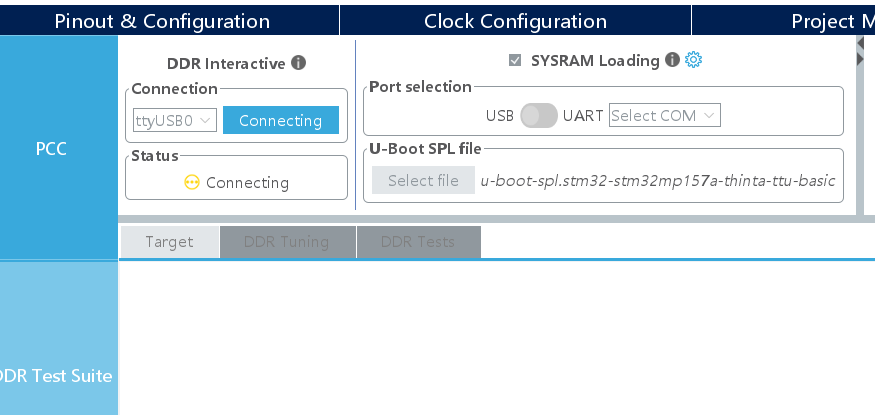

Thanks for your reply.
I had customized the Device Tree according to my board.
But it can't connect to "DDR Interactive". According to the phenomenon, the U-Boot SPL file has been loaded.
The connection status is always displayed in the interface. Does it mean that there is a problem with the LPDDR3 configuration.
Our LPDDR3 model is Samsung's K4E8E324EB, and refer to the LPDDR3 parameters of STM32MP157AAA3 only support 16bit-LPDDR3
Did you check the 5.3 in https://www.st.com/resource/en/user_manual/dm00104712-stm32cubemx-for-stm32-configuration-and-initialization-c-code-generation-stmicroelectronics.pdf (and particularly check the 5.3.2) ?
DDR Tool should connect to your board even if LPDDR3 settings are not yet good (u-Boot SPL does not use DDR to start). That's the purpose of the tool.
If you are not able to connect, you could have either a mistake on the UART + USB connection (USB used to download u-BootSPL using DFU, then UART used as main control of u-Boot SPL) or a mistake in your Device Tree making it not starting (of badly starting). You should solve that first.
The LPDDR3 settings is only an example you could refer to, but should be checked/refined to your board specific using DDR Tuning tool.

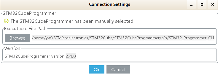

Did you setup the path to CubeProgrammer_CLI (blue config button next to 'SYSRAM Loading") ?
Tip of the day: Try Sidekick STM32 AI agent, see here
Yes, I had setup the path.

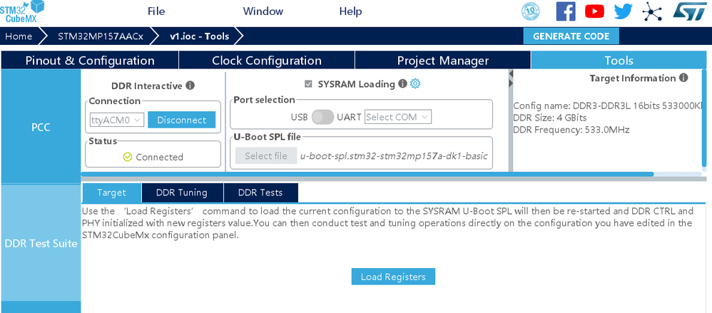

My PC environment is no problem. I have a MP157a-dk1 development board that can be connected to DDR tuning.
If select the U-Boot SPL file I compiled to connect to the MP157a-dk1, the connection status is always been "connecting". So I guess there have some problem with the dts parameter.
Is the log obtained during downloading sufficient to judge that there is no problem with Uart and usb?

Note that If you use STM32MP15-ecosystem-v2.0.0 release, you need to use at least CubeProgrammer v2.5.0.
See https://wiki.st.com/stm32mpu/wiki/STM32MP15_ecosystem_release_note#STM32CubeProgrammer-2C_Signing_tool-2C_Keygen

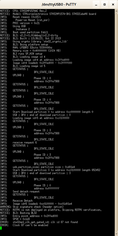

The problem that DDR Tuing cannot be tested has been resolved. The reason is that the voltage of ldo3 of pmic is incorrect, it should be 1.8v for lpddr3.
Now encounter new problems. The debug port returns an error "Clock 87 can't be enabled" during download.
Please refer to the attachment log.7z for the specific log. Please help analyze the possible causes.
