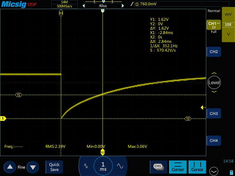

I'm having trouble resetting the board from linux.
Not using a PMIC but discrete power supplies.
I followed the app notes and errata, connecting the NRST and CORE_NRST pins with a cap then later a 0R resistor.
I'm using a single 100nF cap on NRST.
I can see the reset pin going down when rebooting from linux, unfortunately the MPU just freezes.
It looks like it gets stuck in BootROM after reset.
So far only a very long pull down (250ms+) on NRST works.
This or cycling power on VDDCORE which I can't do on my current prototype... (PWR_ON wired directly to VDDCORE supply enable pin)
Reset works fine from u-boot. (booting from SDMMC1, so already enabled)
I remember reset working a while ago, so I'll try to reproduce it and see what is blocking.
Any ideas?
NRST + CORE_NRST signals: (connected together)
I found the issue, it's caused by a circuit on my board: I use VBUS to control a transistor that pulls down some boot pins in order to upload firmware when plugged as a usb device.
There is a capacitor on VBUS that prevents this transistor to turn off fast enough until it reaches BootRom on reset.

PatrickF
NRST+NRST_CORE wired together should work fine if your platform is using VDD>2.7V (i.e. 3.0 or 3.3V typ.).
Did you ensure your boot Flash memory is correctly reset (or power-cycled) ?
As an example, SD-Card setup in UHS-I mode (i.e. I/O 1.8V) cannot go back to standard boot mode until a power cycle is applied.
If Boot is stuck in BootROM, please use https://wiki.st.com/stm32mpu/wiki/STM32MP15_ROM_trace_analyzer and provide the traces.
Regards.
