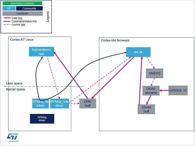

I have a firmware doing permanent acquisition and processing of a signal coming from SPI on the M4 side - consider it an audio stream.
On-demand I would like to save the processed buffer (say ~10 consecutive buffers once in a while, e.g. 1s every 10s) from the SRAM to a permanent file accessible from the A7 Linux userspace.
What would be the best way to do this with the least impact on the M4 load ?
My first guess was DMA from SRAM to DDR and then have Linux write from DDR to eMMC/SD but isn't there a more direct way ?

Hello @YChen.12​ ,
I understand that you want to store data in A7 side that are coming from M4 side.
Please look at this demonstration application: https://wiki.st.com/stm32mpu/wiki/How_to_exchange_data_buffers_with_the_coprocessor
This page explains how it is possible to send large data between the processors and it details two methods.
Since you are sending audio, I think the best method for your case is the one with large buffer in DDR. The one with rpmsg_sdb driver (RPMsg shared data buffer):0693W00000FBCx7QAH.jpgThis method must be used when the Data flow sampling frequency is more than 5 MHz.
By following the page, you are able to realize some tests with the logicanalyser application
