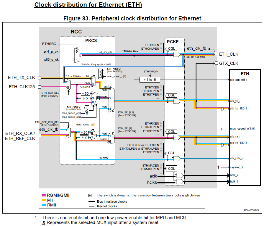

Hi, I designed a board with stm32mp135 and YT8531 phy chip. The ETH1 is not working and ETH2 is work good. They all output 125Mhz from phy to mac. But the ETH1 has reset dma failed. I had measure the 125Mhz is correct on phy side.
Below is my dts code

Hi @Community member​ ,
You are right, usually this 'reset dma' error is linked to a missing clock to the ETH GMAC IP inputs during initialization.
Please have a look to https://wiki.st.com/stm32mpu/wiki/Ethernet_device_tree_configuration#RGMII_with_Crystal_on_PHY-2C_CLK125_from_PHY_-28Reference_clock_-28standard_RGMII_clock_name-29_is_provided_by_a_Phy_Crystal-29
If this suit your use case.
Maybe have a look to Reference Manual RCC section to understand the RGMII clock possible paths.
_legacyfs_online_stmicro_images_0693W00000bkrrUQAQ.pngRegards,

Jean-Marc S
please also check the Getting started with STM32MP13x lines hardware development - Application note for correct connection of the 2 ETH on the board if needed.
