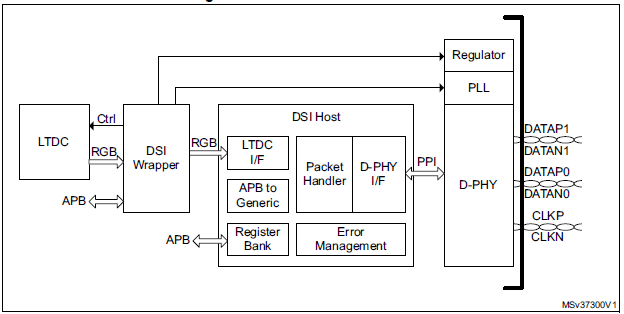

I am working with a custom board based on an OSD32MP157F SoM. The pinout is very similar with the DK2 board with some minor differences, mainly the DSI_RESET pin. I have done several tests on STM32MP157f-dk2 boards with an eDP display that connects through a MIPI/eDP bridge to the DSI port of the DK. This works fine for a while now.
In the custom board I do not have included any ltdc peripheral as I thought that it is not needed for driving the DSI bridge. I made a new image with the corresponding pinout and the bridge i2c driver initializes normally as seen in the bootlog.
[    1.735336] lt8911exb 0-0029: Success request pwr-gpio
[    1.740362] lt8911exb 0-0029: Success request rst-gpio
[    1.747446] lt8911exb 0-0029: LT8911EXB i2c test success chipid: 0xe0517
[    1.785822] lt8911exb 0-0029: LT8911 tx pll locked
[    1.833083] lt8911exb 0-0029: video check: Vtotal = 0
[    1.838486] lt8911exb 0-0029: video check: Hact(word counter) = 0
[    1.844158] lt8911exb 0-0029: video check: Vact = 0
[    2.143622] lt8911exb 0-0029: LT8911EXB setup finish.
But when I try "modtest -M stm" I get a
failed to open device 'stm': No such file or directory
I investigated the entries in /dev and there is no drm entry either.
During troubleshooting I found this post from a few years ago that shows great similarities with my current issue. Looking at the LTDC wiki I can see that the LTDC binds to the DRM/KMS framework. My main hypothesis at the moment is that the DRM framework never initializes since there is no LTDC entry or peripheral. I was wondering if this hypothesis is correct and if yes if there are any ways of using the DRM framework only for DSI.
I attach some parts of the device tree here in case they are helpful. Any ideas or suggestions are highly appreciated
PatrickF
Hi @KChar.1​ ,
DSI get their pixel internally from LTDC, so LTDC is mandatory (without any pins if used with DSI).
_legacyfs_online_stmicro_images_0693W00000bks85QAA.pngI'n not DT expert, but you might have a look to https://wiki.st.com/stm32mpu/wiki/LTDC_device_tree_configuration with examples used for DK2 boards

Hey @PatrickF​ , thank you so much for this! Indeed I was confusing the hdmi_transmitter with the LTDC. I declared the ltdc without any pins on my DT and I can see that modetest -M works but it can not find any panels:

When I try to load the panel manually with
# modprobe panel-orisetech-otm8009a
I get no errors.
I can see that there are no connectors on the modetest which makes me think that the dsi is not recognised. I leave my dsi dt entry below:

Any ideas on how to continue troubleshooting the issue?
I looked a bit closer to this and I realized that after changing the ldtc entry I forgot to change the DSI_RST entry to the correct config. Works fine now! Thank you so much @PatrickF​
