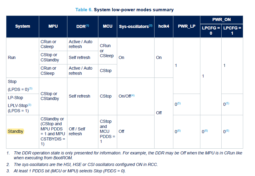

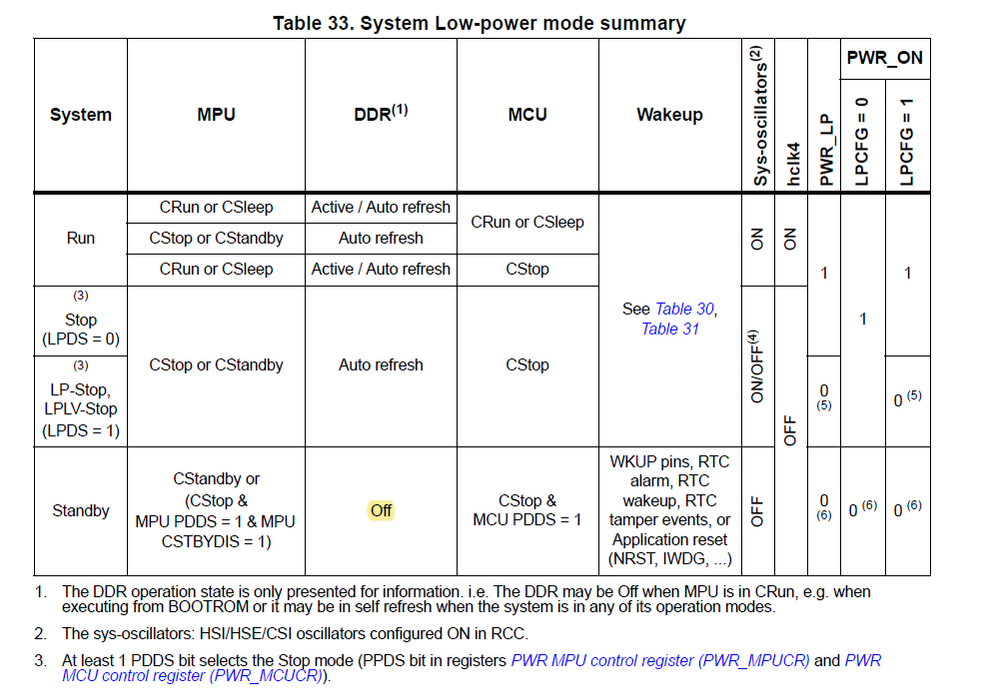

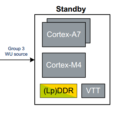

Thank you very much for your answer. I'm still a beginner for low power mode and linux kernel, so I'm sorry that I have so many questions to ask.
1.The Table 33 in doc STM32MP157xxx reference manual RM0436.pdf mentions that DDR is off in System Standby Mode:
However, if DDR is off, the platform must be reboot after wakeup. But in the doc  AN5109 low power application note , Figure 7 shows that DDR isn't off, the Table 6 shows that the DDR status is off or self refresh:
So what is the true state of DDR?

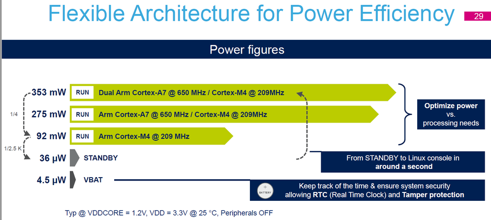

2.How do you define the Wakeup Time after exiting from System Standby Mode? The ppt STM32MP1 Microprocessor - Continuing the STM32 Success Story mentions the wakeup time is around 1 second,
But if I count all the log time after pressing the wakeup button, it's more than 2s.

So how do you define the time from Standby to linux console?

1/ in Standby mode, you have the choice to switch off the ddr or to keep it in self refresh "SR" (both are supported).
  • The advantage of going in DDR SR is that you will wake up more rapidely (Linux running context is saved then you have to switch on the devices, the clocks and jump into where you were in linux before going to run state (TF-A is mainly doing this jog).
  • The drawback of going in DDR SR is the power consumption of this DDR mode (typically 10mW for a lpddr2).
  • The drawback of going in DDR off is that you will need a complete reboot (so you lose your system context (if not saved in backup RAM) and your wake up time will be longer.
2/ 1 sec for standby wake up is what is achievable for a final product. We already confirmed this value customizing a bit the SW on DK2. DK2 standard delivery is a development platform so not optimized for power (even if all the power mechanisms are present and can be experienced). For example, full debug is activated and almost all the peripherals.
