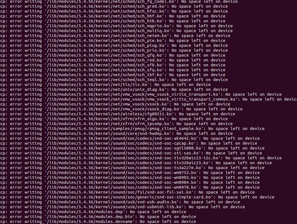

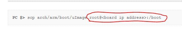

Hi @Community member I was unable to connect my pc to the board using ethernet, because of IP differences. Resolving between IPv4 and IPv6 has become too complicated for me since the board has no editor that I can use to edit the files indicated at the link you provided; in future I will use a router between my pc and the board, but I need this problem to be solved now before I get the router. My work around was by copying to a USB memory stick all files that were supposed to be sent by the command
PC $> scp arch/arm/boot/dts/stm32mp157*.dtb root@<board ip address>:/boot
in Section 5.2 here Modify, rebuild and reload the Linux® kernel - stm32mpu and transfer them to the board manually.
The problem comes again as a I move to Section 5.3 where the command
PC $> find install_artifact/ -name "*.ko" | xargs $STRIP --strip-debug --remove-section=.comment --remove-section=.note --preserve-dates
fires the following error
If I ignore that error and proceed by copying all files intended by the command
PC $> scp -r install_artifact/lib/modules/* root@<ip of board>:/lib/modules
then I run into memory problems where many modules of the kernel cannot be installed because of insufficient space as shown below.
Do you have any ideas to go around it? Please @Community member and @Sisyphus38 help with your expertise and experience with this board

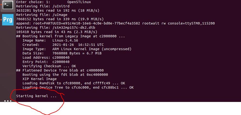

However, I've got another serious problem that following the instructions of Section 6 to recompile the kernel as presented at Modify, rebuild and reload the Linux® kernel - stm32mpu
Now the board is failing to load the recompiled kernel; it stops here and restarts again.
Any advise how to address it?
