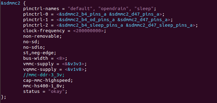

We are trying to enable/configure HS200/HS400 mode in eMMC on STM32MP157F-EV1 evaluation board.
We are using the stm32mp157f-ev1.dts device tree and we have configured the eMMC node as shown in below screenshot.
As per the documentation, we came to know that to select HS200/HS200/HS400, VCCQ has to be set to 1.8 V or 1.2 V.
So, we have set "vqmmc-supply" property in device tree to 1.8 range regulator i.e. "v1v8" as shown below.
v1v8: ldo6 {
                regulator-name = "v1v8";
                regulator-min-microvolt = <1800000>;
                regulator-max-microvolt = <1800000>;
                interrupts = <IT_CURLIM_LDO6 0>;
For the above changes, we are facing the below errors.

PatrickF
Hi @Pratik Manvar​
On STM32MP15 series, There is no dedicated supply rail for eMMC IOs, so you can't do HS200 without changing the whole VDD IOs to 1.8V.
Furthermore, HS200 has some limitations and you should stick to eMMC high-Speed DDR (up to 104MBytes/s) which works at 3.3V.

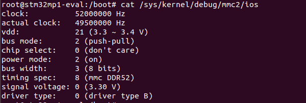

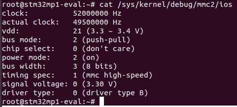

Hi @PatrickF​,
Thanks for your quick reply.
Yes, we understand the limitation to set HS200 mode of eMMC in STM32MP15 series platform.
We are able to set High-Speed as well as DDR52 mode of eMMC (please see below snaps).
0693W00000UnnjIQAR.png0693W00000UnnkQQAR.pngIn both the cases, the clock is 52MHz and we can measure the same write throughput using dd command.
Can you please help us to understand, what is the practical read/write speed for High-Speed and DDR52 modes of eMMC?

Hi @Pratik Manvar​
I can only state for raw bandwidth.
See Table "SDMMC operation modes e•MMC" in STM32MP15 Reference Manual.
I guess the 'High-speed' you got is SDR, so 49.5MBytes/s raw bandwidth (as real clock is 49.5MHz).
The DDR52 is then going twice as fast, so 99MBytes/s raw bandwidth.
The real throughput depend on the memory performances with the block size used by Linux (most of the time not really clear from part eMMC datasheets) and as well by the Linux driver efficiency.
The THGBMBG5D1KBAIT on STM32MP157F-EV1 is stated for DDR52 at 88MB/s read and 12MB/s write. This is maybe not achieved on a real platform due to some SW overhead.
