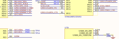

I spotted that the documentation and code examples do not match for port pin assignments for LED2 and LED 4.
The user manual manual does not match the schematics:
Code examples do match the schematics, so just a documentation error I think.
EDIT:  There is definitely some sort of misalignment here.  The Linux device tree (stm32mp215f-dk.dts) puts the blue LED on PZ3.  And when controlled on/off or heartbeat through Linux, the blue led labelled LD2 on the dev kit is controlled.  So this seems to match the user manual!

I can only assume the LED labelled LD4 on the dev kit is wired to pin PF10?

Hi @ADunc.1 ,
quickly checked, I think there is no mistake, just component numbering (which is automatic I guess) that are not aligned with PCB signal naming (alignment is not mandatory although is create headache).
  • PZ3 schematic signal name is LED4, and control the blue LED labelled LD2
  • PH12 schematics signal name is LED3, and control the orange LED labelled LD3
  • PF10 schematics signal name is LED2, and control the green LED labelled LD4
  • PH4 schematics signal name is LED1, and control the red LED labelled LD5
Regards.

@PatrickF Thanks for checking.  Yeah, it's not super ideal having them labelled inconsistently, but not the end of the world.  Perhaps a note in that table in the user manual would help clarify.
