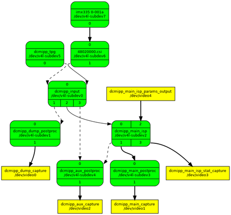

@Pwxn Thanks for the pointers for this. After some looking for a timing problem like you mentioned, I found that the clock frequency needed to be a little different from the default value, so I updated the clk_ext_camera clock frequency in the device tree.
I noticed that, after changing the clock frequency, it looks like it recognizes the IMX664 camera specifically now, at 0x10 as expected:

The registers 0x3071 and 0x3070 are defined in the driver as IMX664_REG_GAIN_HI and IMX664_REG_GAIN_LO, respectively, and I am seeing a new device with v4l2-ctl --list-devices, /dev/media2. I would have expected it to be a /dev/videoX device, but other than this, does the behavior seem correct?
Hello @rdmikkelsen
Good work on bring up the probe. The behavior you observe is mostly correct now.
I have limited experience on image sensor driver, it is hard for us to guide you more on this, specially on the register or mode you want to implement.
However, now that you probed your sensor you should see it as a /dev/v4l-subdevX. What you need to do now is to tune the V4L framework to create your pipeline.
https://wiki.st.com/stm32mpu/wiki/STM32MP2_V4L2_camera_overview
You camera sensor should not be a /dev/videoX as it the output of our DCMIPP pipeline: see the chapter on topology
Try to configure the DCMIPP pipeline with V4L, if you encounter some issue we will try to help you.
Also, I recommend comparing the other camera sensor driver in linux/driver/media/i2c. The imx335.c will give you some hint on using v4l on driver side.
