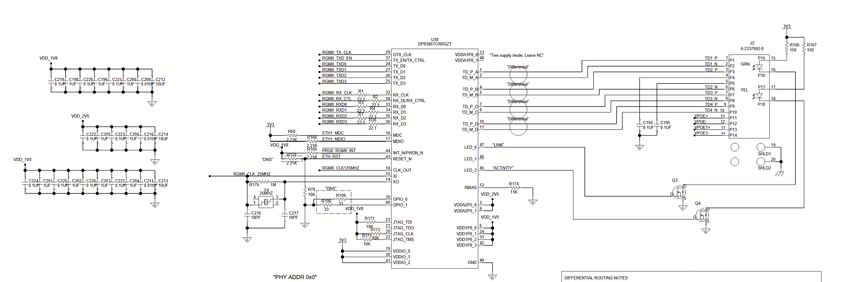

Do you have some schematics you are able to share ? At least the part between the SoC connections and the PHY ?
I see you tried a lot of different method and properties, but I think the best way is to focus on one goal you want to reach and investigate in this sense.
If you tried to generate the 125MHz from the outside (the PHY), I guess you have a 25MHz crystal in your design. You should so at probe time, see at one moment that this 125MHz clock comes in input of the SoC (ETHX_CLK125 pin).

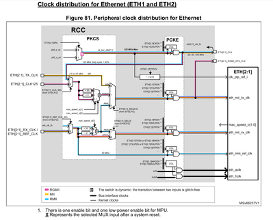

Do not hesitate to check too at this wiki article that can help: https://wiki.st.com/stm32mpu/wiki/Ethernet_device_tree_configuration

I am aware of the ETH1_CLK_SEL which is set by the: st, ext-phyclk. If we are discussing having the phy generate the clock, this parameter should be removed from ethernet1 node in .dts.

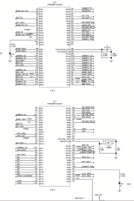

Here is schematic:
SoC:
Phy:

I begin to review the information you gave above. I just begin but I already see that the interruption described in the DTS under mdio node looks wrong isn't it ?
According to your schematics, it seems that the interrupt is coming on PG12 but the device tree mentions PG11. PG11 looks like an unconnected pin.
[Edit: I see you declared it in pinctrl directly, but I do not understand so what is this interrupt declared in mdio node]
Kind regards,
Erwan.
@devinschubert14 ,
I took a look at your pinctrl and compared with your schematics, OK for most of pins but I am surprised. I do not see the ETH_RGMII_RXCLK. It should come on PA1 according to your schematics and is mandatory to get a correct setup.

I think this is just remnant from me debugging, I have removed it from the ethernet node.
@Erwan SZYMANSKI
Good catch! That was definitely a mistake on my part.
I have made the change to the dts and it seems I am getting the same error. I noticed the phy still was not generating a 125MHz signal so I tried generating the clock internally and same error message.
