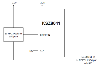

Can someone please help. We are trying to implement a KSZ8041FTL Ethernet PHY using an STM32MP157C. We are not able to connect to the device via MDIO. The device does not respond.
PZak.1
We are trying to implement a KSZ8041FTL in an embedded design. We are using an STM32MP157 device in a SOC provided by Octavo systems (OSD32MP157C-512M-BAA). We have used design resources provided by Microchip and followed examples provided. We have followed resources provided by STMicro to configure the pin connections and device tree for the PHY. We are not able to connect to the device via MDIO. The device does not respond. The resulting output on the Linux kernel log indicates that MDIO device at address 3 is missing. We have the device strapped to address 1. We see MDC and MDIO activity when the device is being probed but it always reports device missing at address 3. There is no response from the PHY. We have verified the presence of the 50Mhz ref to the PHY and monitored the reset line, configuration pins, and address pins. Nothing appears wrong. What are we missing?

00800000 is indeed the good value (the value that you've found in U-boot) it matches the product Reference Manual RMII with oscillator. If you found this value also in Linux, that means the s/w config between the GMAC and PHY is correct for RMII with Crystal configuration.
What about the PHY itself, any activity whasoever (TX/RX lines). What about the PHY driver default configuration regarding the clock source 25MHZ/50MHz? Any PHY bootstrapping config that I've mentioned earlier? Did you check reset/VDD potential issues ?

It looks correct according to your expectations. Same as U-Boot. I have been unable to test the TX/RX lines but I will do so first thing in the morning. We have verified reset and VDD. Also we have FXEN=0 to disable fiber mode. I will pour over the design checklist again from Micrel to make sure we do not have bootstrapping or any other issues.
When you mention PHY driver default configuration regarding the clock source 25MHZ/50MHz, do we need to make any adjustments to the device tree to accommodate this?
The design checklist from Micrel demonstrates that we should be OK with the PHY and MAC sharing a clock source.

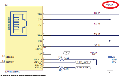

Hello Olivier,
I will include these entries back into the device tree. We just found a hardware wiring problem where we neglected to tie the RJ45 magnetics transformer center taps to VDDA. I have a board being reworked right now and will let you know if this solves our connection problem.
Best regards and thank you for continuing to support us,
Paul

OlivierK
Hello Paul,
Thank you for your kind message.
The root cause of the issue was the RJ45 magnetics transformer? or maybe something else? This is also to help others on the community.
I'm glad that you are sorted out eventually.
Best Regards,
Olivier
Hello Olivier,
Yes, the root cause of the connectivity issue was the missing power connection to the RJ45 magnetics transformer. We have tested and confirmed the PHY is fully functional.
