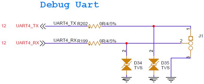

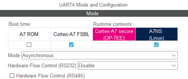

4.1.1 Debugging Serial Port UART
1. Review the schematic and find the debug serial port:

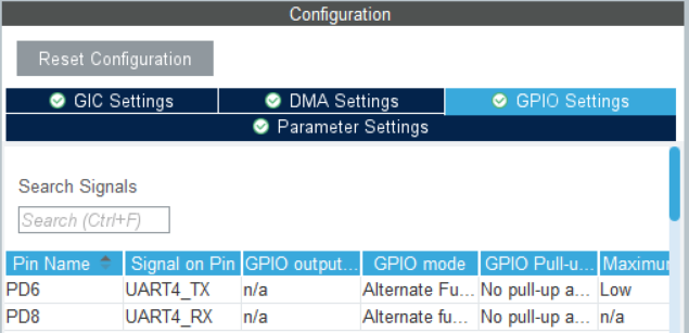

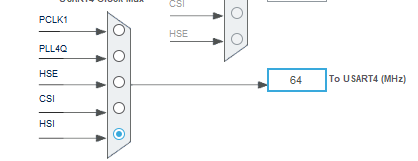

2. Enable UART4, configure the pins and the clock:
Note: The clock for USART4 is using HSI, one reason is to refer to the clock tree configuration of STM32MP135F-DK, and the other reason is to consider the application of serial port wake-up in low-power working mode. Excluding these two points, other clock sources can also be used.
3. Click "Generate code", and add the user code for the serial port configuration of the TFA stage.
Open the generated STM32CubeMX project, open the TF-A device tree (stm32mp135d-myir_bring_up-mx.dts), and add the nodes "choosen" and "aliases" at the "USER CODE BEGIN root".

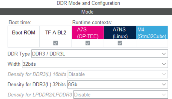

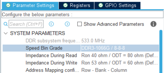

4.1.2 DDR
The following points need to be noted for the DDR configuration:
  • SDRAMS size
  • One/two pieces (16/32 bits), STM32MP13x DDR is 16bits, so the configurations are all using 1 piece of SDRAM.
  • DDR types: DDR3/DDR3L/LPDDRx
  • DDR frequency

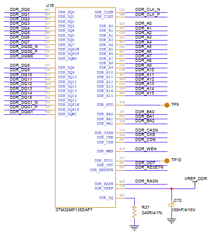

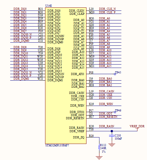

1. Check the schematic diagram of the DDR design section, confirm the size and frequency and other parameters, and complete the design of the DDR part.
Below are some examples of different DDR designs and their corresponding configurations:

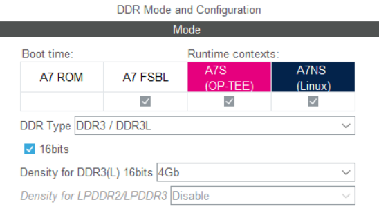

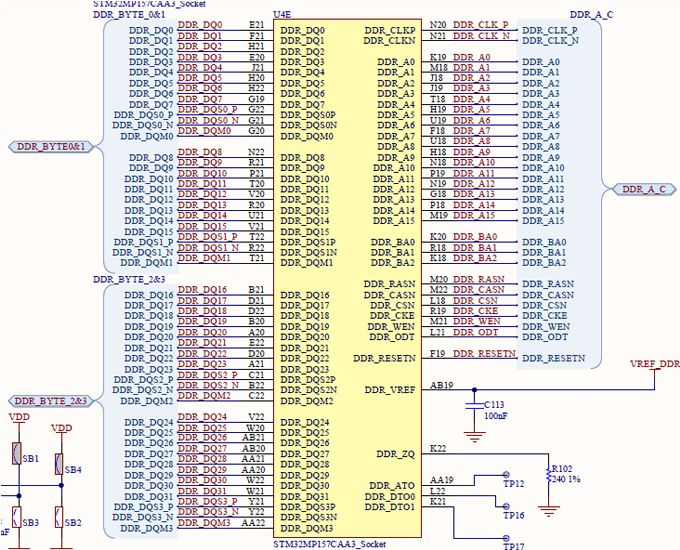

Example 1: STM32MP157C-EV1, two pieces of SDRAM, 32bits, 1GBytes

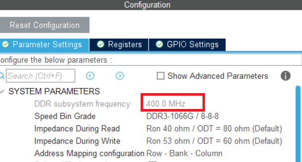

The DDR frequency can be configured in the Configuration interface.

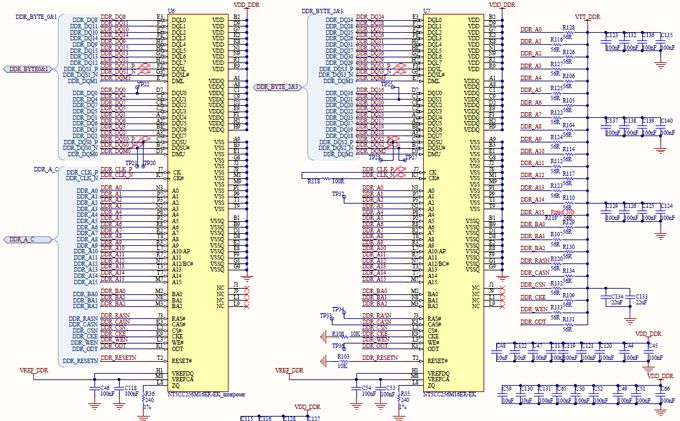

Example 2: STM32MP135F-DK, one piece of SDRAM, 16bits, 512Mbytes.

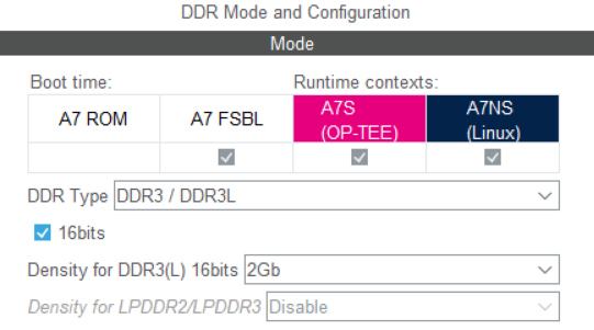

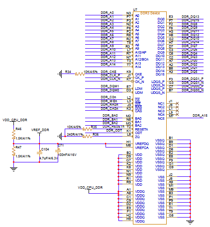

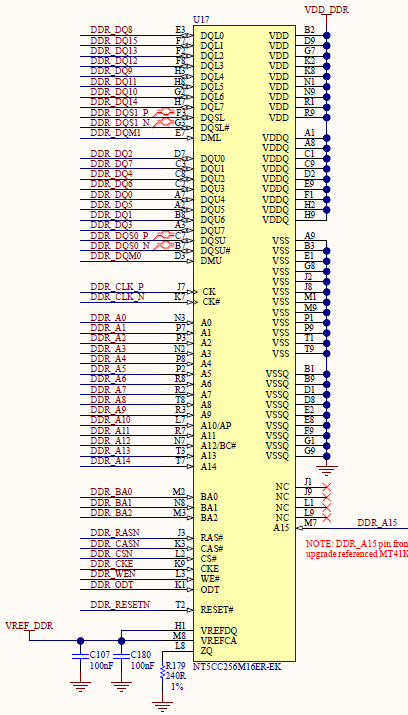

Now lets take a look at the DDR design part of MYIRs MYD-YF13X board:
One piece of SDRAM, 16bits, 256Mbytes, STM32CubeMX configured as follows:
