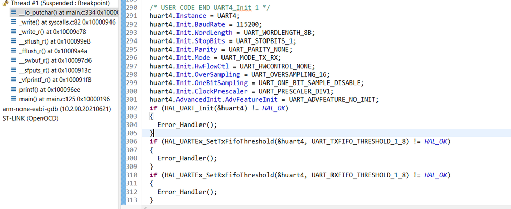

UART 4 logging while connected with st link.Also what does this means : LD Linker > Libraries > Small printf?
2022-06-07 11:33 PM
There may be another variant of this question available but I am reposting it as I couldn't get any success so far redirecting prinf messages to uart4 and viewing them on serial terminal utility.

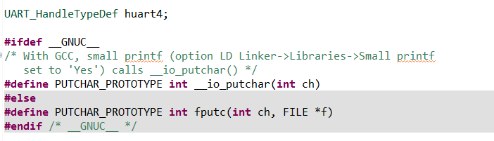

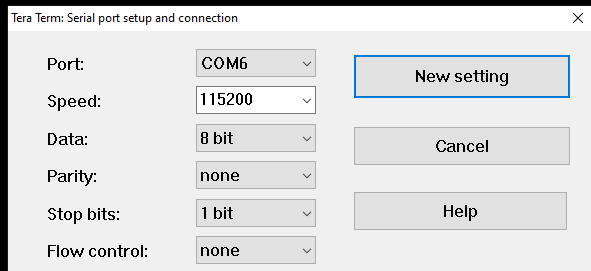

below are the snapshots which shows I have mapped the PUTCHAR method, configured UART4 in the fw and also the serial port utility is having the same connections but I am not able to get any data on the terminal.
The code has a comment: LD Linker > Libraries > Small printf > am I missing this step? Where do I have to do this in the IDE Settings?

Any update on this. Is it even possible to get the logs while we debug simultaneously on the ST LINK port? Just like in NUCLEO Boards.
