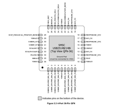

I have checked the hardware configuration and it seems to be in order. I have checked the voltage levels. It seems very OK as well.
  • All VDD are 3.3V
  • Alla REM[0:1] is 0V
  • VBUS_DET is 3.3V
  • RBIAS is about 1.2V because there is a 12 kOhm pull-down resistor there
  • All PRTPWR[0:3] are 0V
  • All SEL[0:1] are 0V
  • TEST is connected to GND
  • All OSC_N[0:3] are closed with their pull-up on about 2.5V
  • RESET_N is 3.3V
  • PLLFILT is connected to a capacitor to GND
  • XTALIN is 0.63V
  • XTALOUT is 0.64V
  • USBDM_UP is 0V
  • USBDP_UP is 3V

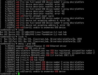

Once RESET_N goes low, the error codes in Linux terminal will re-write the error codes again. So I guess that the RESET_N is working on the USB hub.
[...] usb 2-4: device not accepting address 27, error -62
[...] usb 2-4: device descriptor read/64, error -62
[...] usb 2-4: device not accepting address 29, error -62
[...] usb 2-4: device not accepting address 30, error -62
[...] usb usb2-port4: unable to enumerate USB device
Error -62 is:
(Time out: ETIME 62 /* Timer expired */)

Conclusion:
In my opinion, I think that usbh_ohci might be used all the time, because if I disable usbh_ehci, I still get the same error, only if I declare the hub@1 inside one of the usbh_ohci and usbh_ehci.
What do you think?
The USB2514B is broken?
Note: It's the legacy USB2514B from SMSC, not from Microchip. But I'm guessing that it should be no difference.

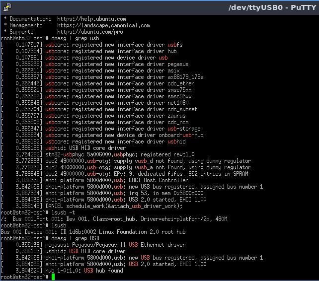

If it helps. here the log on STM32MP157F-DK2 (nothing connected on USB):
root@stm32mp1:~# dmesg | grep usb

root@stm32mp1:~# lsusb
Bus 002 Device 001: ID 1d6b:0002 Linux Foundation 2.0 root hub
Bus 001 Device 002: ID 0424:2514 Microchip Technology, Inc. (formerly SMSC) USB 2.0 Hub
Bus 001 Device 001: ID 1d6b:0002 Linux Foundation 2.0 root hub
root@stm32mp1:~#

Hi @PatrickF
I totally agree!
When I disable "status = "disabled";" on usbh_ohci, I get no error -62 at all.
But I cannot verify if usbh_ehic have establish a communication. Is it something more I need to do?
It's the CubeIDE that generates the node @usbh_ohci by the way.
