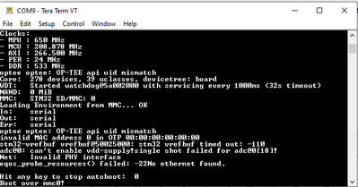

We are using STM32157AAA3 Processor in our custom board.
we are trying to ping ethernet in RMII (100mbps)mode  in uboot (2023.04) version.
we are  facing following issues :
1. Invalid PHY Interface.
2. eqos_probe_failed() -22 No ethernet found  (as in below screenshot).
 when we try to ping ethernet in RGMII Mode with auto negotiation  we are getting Host is not alive.
But in uboot 2018 version it is working fine in RMII (100mbps).
Please find the below attached screen shots for configuration,what we have done  for ethernet in uboot-2023V.
please help us in this regards.

Hi @Navaneeth kumar
Latest STM32MP1-ecosystem-v5.0.0 uses U-Boot v2022.10-stm32mp-r1
uboot-2023.04v is not yet supported on STM32MP1 platforms.
See STM32 MPU ecosystem release note
