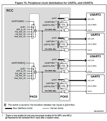

Are you able to dump USART3 registers (base address 0x4000F000) ?
When you say no output, is there no valid data or no signal at all (even at wrong baudrate, seen with oscilloscope ) ?
Maybe issue on USART3 settings in RCC (USART35SRC and USART3EN)

Thank you for bringing up USART3EN, the setting there was wrong, but even fixing it did not help.
When dumping USART3 base (mapped to 0x4000F000 in HAL, so mapped correctly) I have noticed a strange behavior:

It is clear from the dump that something is preventing (there is no interrupt that jump so not the mmu) the write or for some reason the memory is read only?
As far as I am aware, I am booting the basic boot (non-secure), and the SPL is not suppose to block this memory region in any way.
Am I mistaken in my assumption of secure area during boot?
Is it a mater of timing, where the register needs to be updated before changing anything in the RCC?
Or is there something else completely that I am missing?
Hi @Amit_Bl
as already says, we did not support bare-metal nor SPL, so I cannot help much more.
You should debug your MMU, ETZPC and clock settings.
