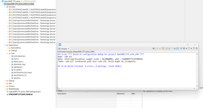

I am trying to get the TTY echo example running on my discovery kit. Everything seems to go fine until I get to the point of starting the debugger. When I click the debug button nothing happens. I am running the IDE in Windows 10 if that matters. I am a hardware guy and I don't have a Linux box to use.
More info: When I do the build it finishes with 0 errors and warnings but does say that the build might be incomplete.

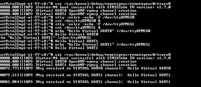

If you want to see the logs, it will come on different console.
If you see you will find logs on 3. MPU SERIAL (Connected).
Here you can see the logs like this , I have used the commands present in readme.txt of this application:

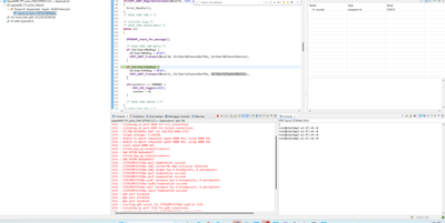

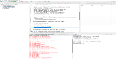

I have run OpenAMP_TTY_echo application present on this link:
https://github.com/STMicroelectronics/STM32CubeMP1/tree/master/Projects/STM32MP157C-DK2/Applications/OpenAMP/OpenAMP_TTY_echo
It is working as expected; logs are coming and the LED is blinking:
I am attaching the screen shot for the same.
Have you opened TeraTerm or some other software to see the logs?
On this part, there are chances that there are no files included in build.
https://github.com/STMicroelectronics/STM32CubeMP1/tree/master/Drivers/STM32MP1xx_HAL_Driver
you can check whether these files are included or not.

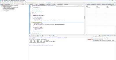

I am using the console that is in the STM32CubeIDE. I removed the project from the IDE and imported it again. It appears that there are files included in the build.
This is after I did the build.
I am trying to follow this example: Modify, rebuild and reload a firmware - stm32mpu. This uses the same files as in your link above. I did notice that there aren't any binaries imported with the project.

jollyjoe
Thanks Shivam,
It was the firmware package that was the culprit. I had originally downloaded it from a link on one of the "getting started" pages. Apparently that link went to an older version.
