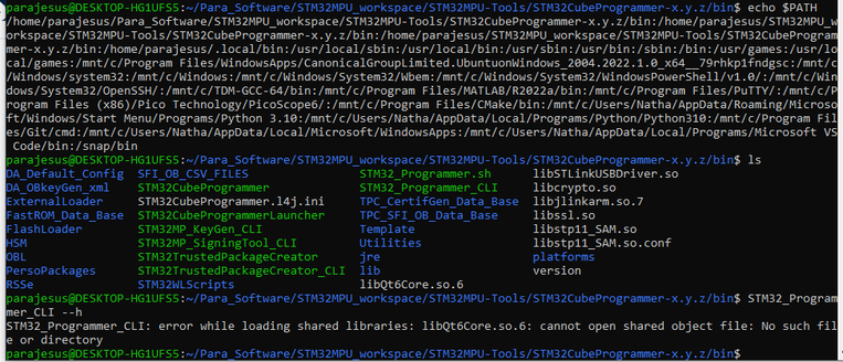

Hello @Erwan SZYMANSKI
I am having the same issue. Here are the outputs to the commands you suggested.
Thank you,
Jesus
Erwan SZYMANSKI
May 20, 2024
Hello @Jesus5611 ,
In you case, this is not an error of PATH variable content, but more an installation issue. It tells you that libraries for Qt6 are missing.
I advise you to reinstall your tool.
Kind regards,
