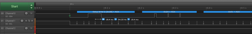

In my device tree, we config 400KHz, but on scope we see only ~ 50Hz, and the clock seems weird. Anyone know why?
&i2c1 {
pinctrl-names = "default", "sleep";
pinctrl-0 = <&i2c1_pins_a>;
pinctrl-1 = <&i2c1_sleep_pins_a>;
i2c-scl-rising-time-ns = <185>;
i2c-scl-falling-time-ns = <20>;
clock-frequency = <400000>;
status = "okay";
/delete-property/dmas;
/delete-property/dma-names;

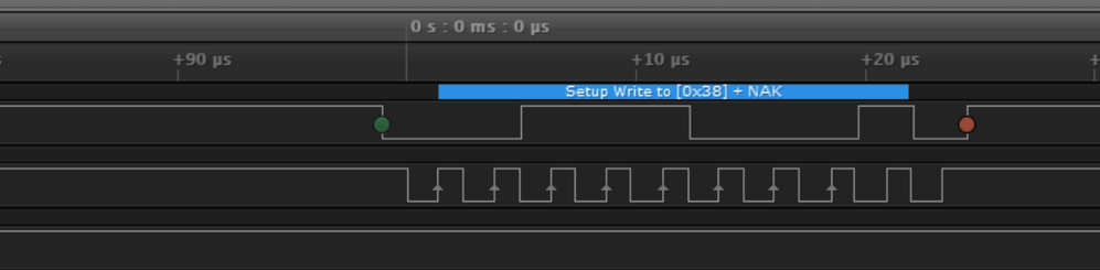

We did a bit more investigation and found that 'drive-open-drain' causes this issue. When we temporary remove this line in device tree see that the clock is 400KHz as well.
But when we remove drive-open-drain then I2c transaction failed, but the clock on scop looks correctly.
Do you have any idea why when add drive-open-drain the clock become weird?

Seem change bias-disable to pull up everything work well
