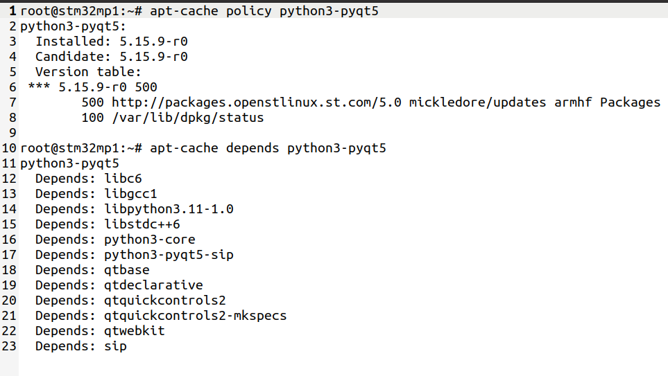

‎2023-10-19 9:43 PM - edited ‎2023-10-19 9:57 PM
Hello @Jean-Marc B
I am grateful for your response and I received the following output.
And still i am getting the following error.
root@stm32mp1:~# su -l weston -c "env QT_QPA_PLATFORM=wayland-egl /home/weston/essai.py"
Traceback (most recent call last):
File "/home/weston/essai.py", line 2, in <module>
from PyQt5.QtWidgets import QApplication, QMainWindow, QPushButton
ModuleNotFoundError: No module named 'PyQt5.sip'
Thanks & Regards,
Shail

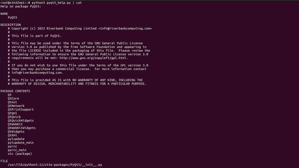

‎2023-10-20 2:17 AM
Hello @Jean-Marc B
Your response is greatly appreciated. As you pointed out, I attempted and obtained the following outcome.
Thanks and Regards,
Shail
‎2023-10-20 3:03 AM
Hi @Shail
Ok, the sip entry is missing in your data while available in my output.
