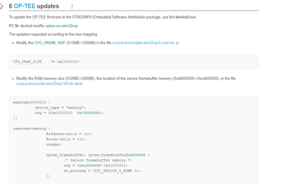

Hi @JKim.2 ,
Sorry to come late in this thread.
We will soon release a wiki page addressing modification to be done while changing DDR Size.
It described reduction from 512 to 256MB but I'm sure it can be relevant for the opposite.
Please let me know if it help
Olivier

Hi Olivier,
Thank you for posting the guidance. ( How to configure a 256MB DDR mapping from STM32 MPU Distribution Package - stm32mpu ) After the compilation, I need to copy the result files to SD card. Btw, according to the tutorial in ST wiki (  How to cross-compile with the Developer Package - stm32mpu ), I found the same "fip-stm32mp135f-dk-optee.bin" should be copied to the sdb5 partition three times as below. Could you please confirm the destination partition is correctly noted in the tutorial? It's hard to understand how it can work. Thanks.
Best Regards,
Jeff

I ran in the not in reserved area issue again.  Always compiled with DEBUG=1. After removing that an all other DEBUG command line options for OPTEE and TF-A, finally BL32 Extra 1 (id 8) and 2 (id 9) were loaded.
Both TF-A and OPTEE need STM32MP1_OPTEE_IN_SYSRAM=1 on the  build command line and OPTEE CFG_STM32MP1_OPTEE_IN_SYSRAM=y CHANGED (not added) in the optee conf.mk file .
This solution worked for me. YMMV. (hope did not confuse anyone else).
Hello Bernard,
According to the initial error log, I set reserved-memory for optee as below. However, the bootlog still shows "TEE load address @ 0xde200000" with the TZC permission failure. Enabling STM32MP1_OPTEE_IN_SYSRAM didn't help. Please review the below boot log.
optee-os-stm32mp-3.16.0-stm32mp-r2/core/arch/arm/dts/stm32mp135f-dk.dts
reserved-memory {
#address-cells = <1>;
#size-cells = <1>;
ranges;
optee_framebuffer: optee-framebuffer@fd000000 {
/* Secure framebuffer memory */
reg = <0xfd000000 0x1000000>;
st,protreg = <TZC_REGION_S_RDWR 0>;
u-boot-stm32mp-v2021.10-stm32mp-r2/arch/arm/dts/stm32mp135f-dk.dts
linux-5.15.67/arch/arm/boot/dts/stm32mp135f-dk.dts
reserved-memory {
#size-cells = <1>;
ranges;
optee_framebuffer@fd000000 {
no-map;
optee@fe000000 {
reg = <0xfe000000 0x2000000>;
no-map;
Best Regards,
Jeff
