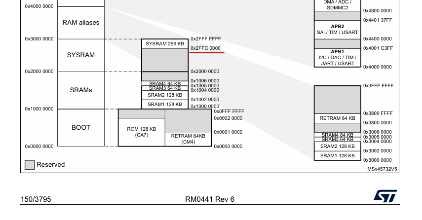

This is the UART output. It seems that
  • I started the SYSRAM
  • My STM32MP151AAC3 can communicate with my PMIC.
I think that the memory configuration is not correct, because I have 4GB RAM.

Conclusion:
I think I have answered my own question.
The problem was that SYSRAM did not start. But now it seems that I have made progress.

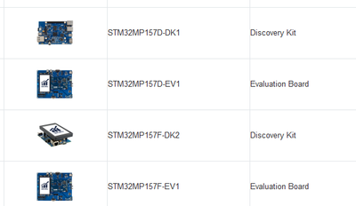

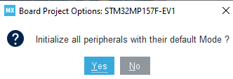

Hi @DMårt
ST boards .ioc configuration could obtained by just loading an STM32MP157x board (EV1 or DK1/2) in CubeMX. But it might not bring so much.
For ST boards .dts, please have a look to this folder https://github.com/STMicroelectronics/arm-trusted-firmware/tree/v2.8-stm32mp/fdts (see  also https://wiki.st.com/stm32mpu/wiki/STM32_MPU_device_tree#STM32MP1_series)
Regards.

The memory map of ARM Trusted Firmware: 6.34. STMicroelectronics STM32MP1 — Trusted Firmware-A documentation
So that means that It's somthing with Bootloader 2 (BL2).
0x00000000 +-----------------+
           |                 |   ROM
0x00020000 +-----------------+
0x2FFC0000 +-----------------+ \
           |     BL32 DTB    | |
0x2FFC5000 +-----------------+ |
           |       BL32      | |
0x2FFDF000 +-----------------+ |
0x2FFE3000 +-----------------+ |
           |     BL2 DTB     | | Embedded SRAM
0x2FFEA000 +-----------------+ |
           |       BL2       | |
0x2FFFF000 +-----------------+ |
           |  SCMI mailbox   | |
0x30000000 +-----------------+ /
0x40000000 +-----------------+
           |                 |   Devices
0xC0000000 +-----------------+ \
0xC0100000 +-----------------+ |
           |       BL33      | | Non-secure RAM (DDR)
0xFFFFFFFF +-----------------+ /
What I have done is to change the build artifact for tf-a sources. I have replaced ..=optee-sdcard with ..=optee-usb.
When I'm trying to build the stm32 meta <project name>-mx build artifact. I'm not sure if that's correct.
I have also change the clocks so they are 100% the same as the default initialization of the system clocks of STM32MP157F-DK1.
Notice:
In STM32CubeIDE, for U-boot and Linux, you need to manually configure the clocks by pasting them into the .dts file. Yes, it's a bug and I hope the dev team of STM32CubeIDE will solve that in next version 1.17.0.
Question:
Which build artifact for tf-a in order to implement it into the SYSRAM by changing BL2?
