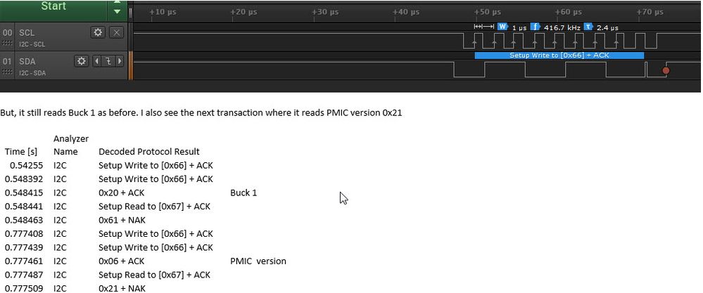

Hi @Community member,
Your help is really appreciated. We can't figure out why it's not configuring PMIC over I2C4. We have traces connected to I2C4 SCL and SDA on the board, and all we see is that it reads from Buck 1 (value 0x61) and reads PMIC version number from reg 0x6 (value 0x21). Doesn't look like the pmic node from the device tree is being used in setting up Buck2 for DDR. Are we missing some configuration in the device tree or some where else? We are stuck!

Last night we traced the output on the I2C and the driver is clearly talking coherently to the PMIC:
There is no reason why it is stopping after just the BUCK1 test. It conforms to the configuration file requirements, so that test should pass, and it should move on to BUCK2, but it does not.

We made our first breakthrough. Not there yet, but much better.
We did not have the Hash and RNG (random number generated) in the device tree enabled. by enabling that, we get much further. It is very frustrating there is no error message or anything that this is required...

ERROR:  BL2: Failed to load image (-80)
and we now have VDD_DDR at 1.35V and VTT_DDR at 0.675V, so the PMIC is alive!
but... obviously the image is not loading into DDR3... any ideas now on this issue?
Terry & Nikhil
TWest.2
Turns out error -80 is:
EAUTH (80) Authentication error!
​"A certificate or image could not be authenticated when Trusted board boot is enabled"
