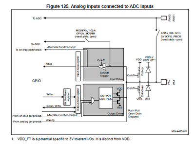

On a proprietary board based on STM32MP157AAA, code was created on the M4 core for reading 11 analog gates managed in DMA (end of sequence interrupt) of ADC1 and ADC2 in independent mode with conversion start via software executed cyclically. The adc values obtained are then passed to the control loop through the command port implemented on /dev/ttyRPMSG0 to the A7NS core where an application runs. Furthermore, a second virtual port (/dev/ttyRPMSG1) was used to trace the execution of the code on M4. The Start/Stop of the M4 firmware occurs via a script that uses remoteproc linux A7 "Non Secured".

When the board is first turned on and the firmware on the M4 is started the readings of the 11 inputs are correct and consistently follow the changes to the inputs. After a subsequent Stop and Restart of the M4 firmware, one of the inputs on ADC1 (IN16 Rank 6 PA0) also appears influenced by the value present on another ADC1 input (IN0 Rank 4 ANA0). That is, both values present in PA0 and ANA0 contribute proportionally to the adc value read of the PA0 input, while all the other inputs (including ANA0) work correctly.
The only way to restore the correct readings is to reboot!

Have you ensure you did not touch the SYSCFG_PMCSETR bits 24 and 25 ?

Default Cortex-M4 generated FW by CubeMx and more generally HAL initialization are somewhat assuming the peripherals are in reset state while it is not the case when you restart the Cortex-M4.

Hi @PatrickF,
the problem of the interference of the readings was due to an incorrect initialization of SYSCFG_PMCSETR as you highlighted, thank you for the assistance provided.
CubeMx had correctly composed the right initialization of this register which predicts the open state of these switches
HAL_SYSCFG_AnalogSwitchConfig(SYSCFG_SWITCH_PA0, SYSCFG_SWITCH_PA0_OPEN);
HAL_SYSCFG_AnalogSwitchConfig(SYSCFG_SWITCH_PA1, SYSCFG_SWITCH_PA1_OPEN);
void HAL_SYSCFG_AnalogSwitchConfig(uint32_t SYSCFG_AnalogSwitch , uint32_t SYSCFG_SwitchState )
  /* Check the parameter */
  assert_param(IS_SYSCFG_ANALOG_SWITCH(SYSCFG_AnalogSwitch));
  assert_param(IS_SYSCFG_SWITCH_STATE(SYSCFG_SwitchState));
  SYSCFG->PMCCLRR = SYSCFG_AnalogSwitch;
  SYSCFG->PMCSETR = (uint32_t)(SYSCFG_SwitchState);
But the problem arises from an inversion of the definitions of SYSCFG_SWITCH_PAx_OPEN and SYSCFG_SWITCH_PAx_CLOSE present in STM32MP1xx_HAL_Driver/Inc/stm32mp1xx_hal.h

By switching the opening of these switches again after the incorrect configuration, the problem was solved! Analog readings are correct even following consecutive Stop/Starts of the M4 firmware.
I am satisfied with the resolution to my problem, although I cannot explain the behavior of the correct readings at the first start of the M4 firmware before applying the fix.
