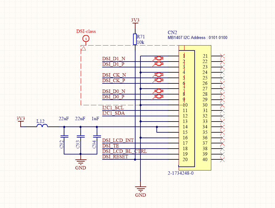

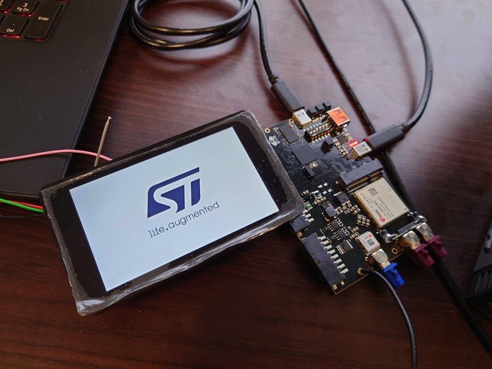

I am using MB1407C (stm32mp157x-DK2 extension board with touch-screen) connected to my custom board. When board is booting I am getting the "ST life.augmented" screen on the U-boot and black screen when kernels starts. Also I am getting the telnet commands when I am updating the flashlayout using the CubeMxFlashLoader - so my guess is the DSI connection is working, but why do i get the black screen instead of the Wayland Weston desktop- that is shown when stm32mp157x-DK2 loads up the OS? What am i missing? What is other way to test the DSI connections?

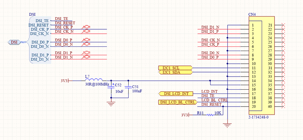

I seems to indicate to problem of vendor, but this same SD runs on eval-board ok... The custom-board has the same pinout and socket for DSI (double-checked).
Also I have checked the 3V3 for the DSI screen and seems to be stable 3V3.
Not sure should I proceed to tripple check the HW (pcb traces etc.) or issue is on SW...
0693W00000Hr74fQAB.pngTOP - eval-board schematics0693W00000Hr76AQAR.pngBOT - my custom board shematics
That you successfully get any image displayed suggests its not a HW connectivity problem.
Start screen suggest that has all the clocking and timing in order for that part (u-Boot ?)

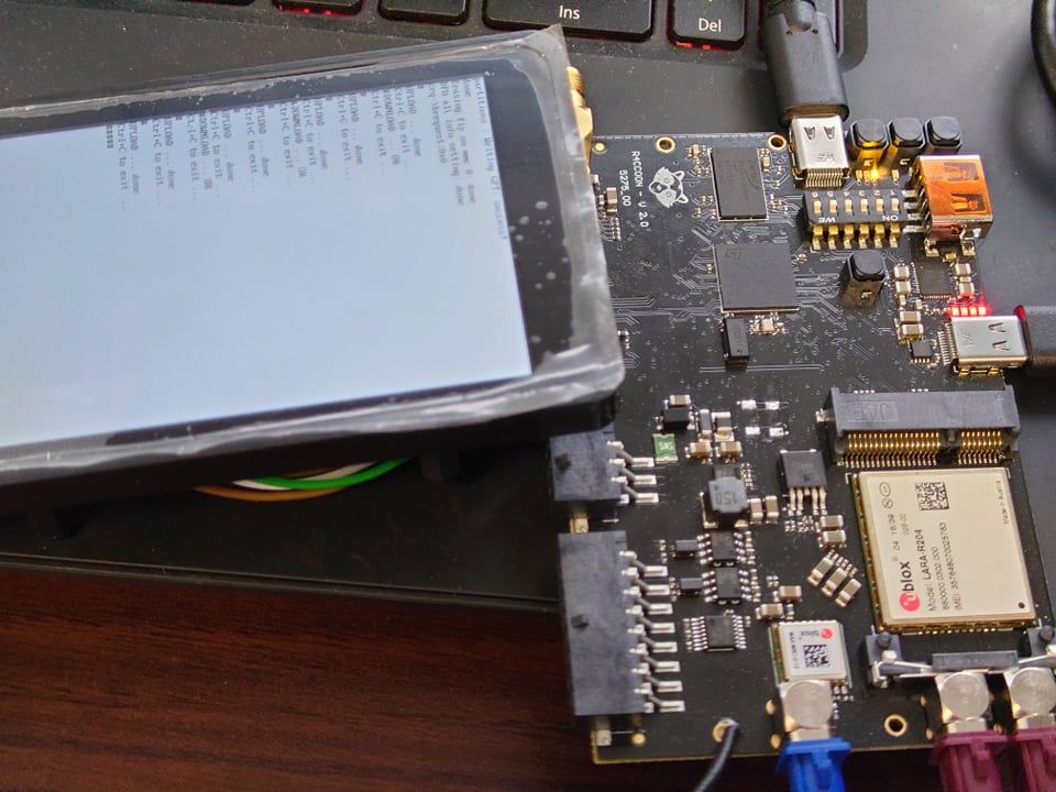

Yep it works in U-Boot and goes dark as soon as it starts up kernel, my hunch tells that it is SW too. I will try a few more things and post update :)

Good morning, @Kevin HUBER​
I just removed HDMI node (because I am not using it at all) as alternative on Kernel device tree - it worked out for me. Thanks!

Good morning @Arnas Celkys​ ,
Nice.
I think the probe of the HDMI probably caused an error that was preventing LTDC/DSI to be configured correctly at linux level.
Great that you find the problem.
