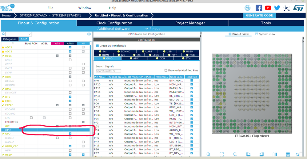

Hello everyone, I use the STM32MP157A-DK1 on my project but I have a problem
1- In the CubeMX, when you want to use a GPIO in output or input, why can not we select the context (cortex A7 or cortex M4)?

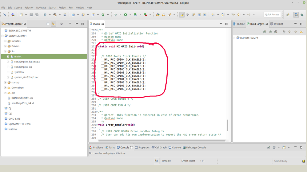

2- When you set a GPIO as an output or input to CubeMX and generate code for SW4STM32, the GPIO you defined is not automatically configured in main.c, can I know why? please

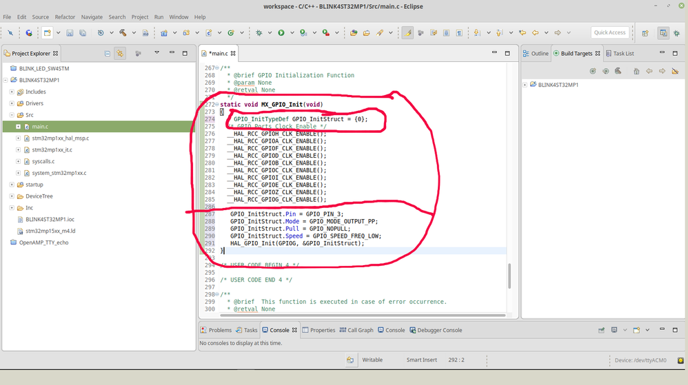

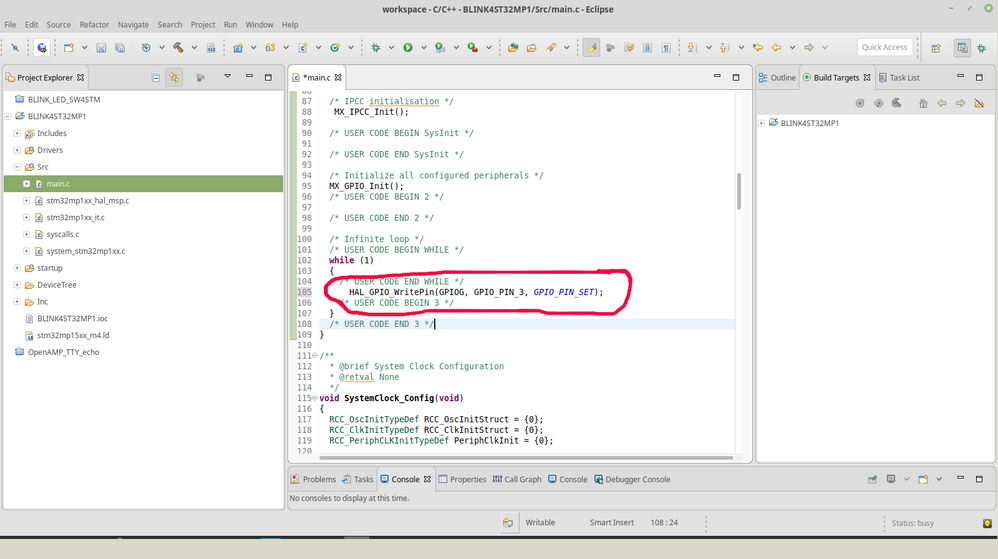

3- In SW4ST32 (main.c), when you manually set a GPIO and try to flash LEDs that you connect to the PG3 for example, no signal arrives on the PORT, did I make a mistake?

2019-07-26 1:58 AM
Hi @djimel
STM32CubeMX is not yet full feature for STM32MP1 and has a limitation today with configuration of GPIO not linked to a peripheral.
You have to manage it in USER SECTION of the Device Tree.
Take a look at https://wiki.st.com/stm32mpu/wiki/GPIO_device_tree_configuration for some useful information
Hope it help
Olivier
