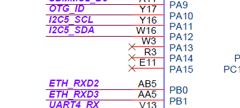

Hello Guys.
I made a custom board from the EV1 circuit base, removing unnecessary parts.
(Most of them are the same as the EV1. Only parts that are not in use have been removed.)
And after creating Device Tree using CubeMX, I succeeded in making my image.
(EMMC's circuit connection and Device Tree are the same as EV1.)
But my board can't boot to EMMC if I remove the RJ45 connection.
If booting without RJ45 connection (Ethernet), I can check the following message.
(The same message could be confirmed even after power reset.)

‎2020-12-22 1:14 AM
In U-Boot there is the possibility to enable "fastboot" to support Android. By default "fastboot" is enabled by pressing the button "User PA13" on EV1.
Some additional detail is available here:
https://wiki.st.com/stm32mpu/wiki/LEDs_and_buttons_on_STM32_MPU_boards#Description
https://wiki.st.com/stm32mpu/wiki/How_to_configure_U-Boot_for_your_board#Config_node
I suspect that in your board you are reusing GPIO PA13 for some other purpose, somehow linked with the ethernet.
As a solution, you can either:
- completely disable "fastboot" in U-Boot, by re-configure it and disable CONFIG_FASTBOOT, or
- move to another button the enabling of "fastboot" by changing in U-Boot the following line in "arch/arm/dts/stm32mp157a-ed1-u-boot.dtsi", or
st,fastboot-gpios = <&gpioa 13 GPIO_ACTIVE_LOW>;
- use another GPIO for the ethernet, instead of PA13.
‎2020-12-22 3:58 PM
Thanks for your answer.
Through your answers, I learned the function of the PA13 and PA14.
​But there is something I can't understand.
There is no connection of PA13 to PA14 in the schematic of my board.​
And the relevant part of my CubeMX Device tree is as follows.

‎2021-01-04 1:37 AM
If you only remove the line
without disabling CONFIG_FASTBOOT you should get an error at boot time.
The option CONFIG_FASTBOOT is activated automatically by the option CONFIG_USB_FUNCTION_FASTBOOT that is in U-Boot default configuration files '<u-boot>/configs/stm32mp15_*_defconfig' and/or in the patches applied to U-Boot by yocto layers.
Disabling CONFIG_USB_FUNCTION_FASTBOOT should fix the issue.
The fact that you have 'interference' from ethernet cable on 'floating' PA13 could be explained with board noise; probably your device tree doesn't set any pull-up to PA13, so it get sensitive to some noise on the board.
