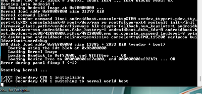

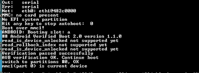

Hi Hicolas ,
Thank you for repply i think some error when i use git apply now i'm fixed ok .
then try to make -j look fine , about HDMI can't support if i need to use also need to edit kernel?
When DK board booting up .. somting mising ?
Thank you
Regards
PK
