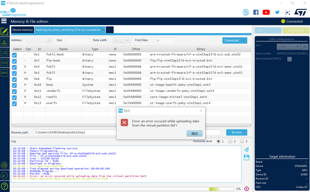

An error occurred("Error: an error occured while uploading data from the virtual partition 0xF1") when I was immigrating the images.
EYANG.1

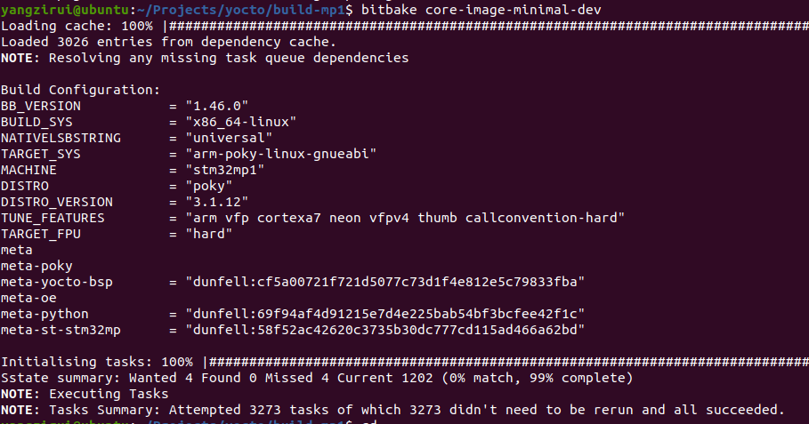

Hi, I downloaded the image file required by STM32MP157-EV1 from Yocto, but this error occurred when I used ST32CubeProgrammer. Does anyone know how to solve it?
Error:
Yocto image information:

Did you succeed to program the Starter Package ?
Could you provide UART log while programming ?
Thanks

Hi,@Community member​ ,
You are right, I did not program the source code, and this is the only message in UART log when I was immigrating images. Is that the cause of problem?0693W00000HordJQAR.png
And yesterday, I created a new (.dts )and (.dtsi) in /temp/work-shared/stm32mp1/tfa-source folder. But I still do not know how to update it and create a renewed image by Yocto so that I could run it at STM32 board. Do you have good idea?

Hi @EYANG.1​ ,
you need check tf-a device tree. The file should contain the settings of the power supply chip ST PMIC STPMIC1. example for STM32MP157A-DK1:

Apparently, at startup, tfa interacts with this chip, and if it is not configured, then fsbl-boot will not be able to load your image via USB.
 I recommend editing the device tree that ST provides
