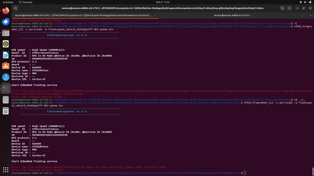

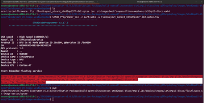

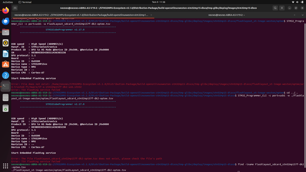

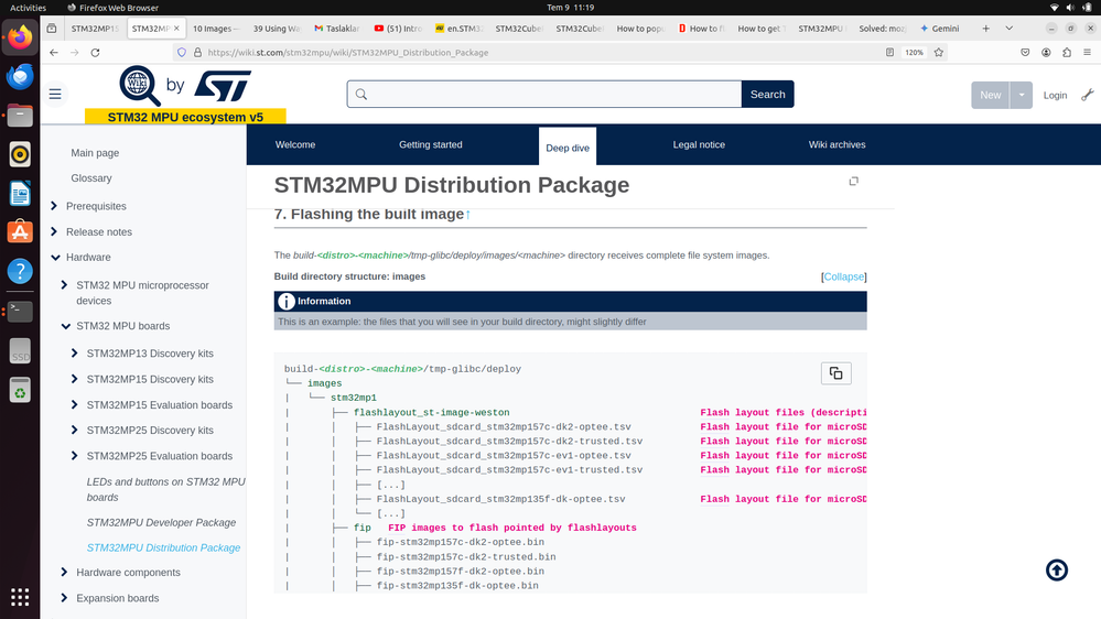

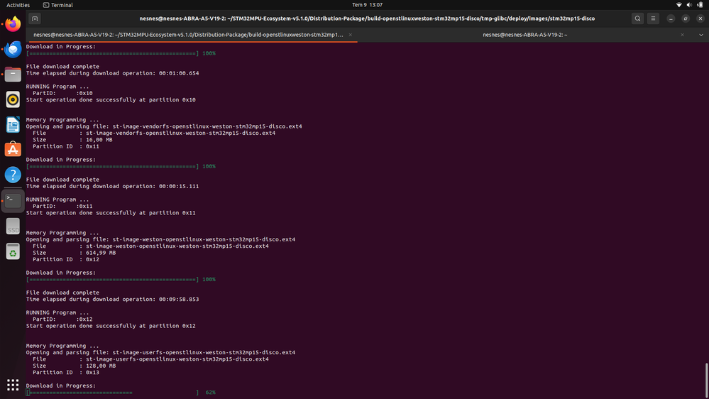

I followed the instructions on https://wiki.st.com/stm32mpu/index.php?title=STM32MPU_Distribution_Package&sfr=stm32mpu to flash my build image on my STM32MP15. After step 6: Where I build the image with the command "bitbake st-image-weston" I go to "STM32MPU-Ecosystem-v5.0.0/Distribution-Package/build-openstlinux-weston-stm32mp15-disco/tmp-glibc/deploy/images/stm32mp15-disco/flashlayout_st-image-weston/optee/FlashLayout_sdcard_stm32mp157f-dk2-optee.tsv" (From Developer Package (SDK) have been built for this st-image-weston image in the documentation). When I tried to flash it to the board with "STM32_Programmer_CLI -c port=usb1 -w FlashLayout_sdcard_stm32mp157f-dk2-optee.tsv" I received "Error: File does not exist: /home/nesnes/STM32MPU-Ecosystem-v5.0.0/Distribution-Package/build-openstlinuxweston-stm32mp15-disco/tmp-glibc/deploy/images/stm32mp15-disco/flashlayout_st-image-weston/optee/st-image-bootfs-openstlinux-weston-stm32mp15-disco.ext4 Error: TSV flashing service failed"
Even though the file I want to flash is in the "STM32MPU-Ecosystem-v5.0.0/Distribution-Package/build-openstlinuxweston-stm32mp15-disco/tmp-glibc/deploy/images/stm32mp15-disco/flashlayout_st-image-weston/optee/FlashLayout_sdcard_stm32mp157f-dk2-optee.tsv" directory, I am receiving an error for "STM32MPU-Ecosystem-v5.0.0/Distribution-Package/build-openstlinuxweston-stm32mp15-disco/tmp-glibc/deploy/images/stm32mp15-disco/flashlayout_st-image-weston/optee/st-image-bootfs-openstlinux-weston-stm32mp15-disco.ext4"
What is the cause of this error and how can I fix it?

@nesnes ,
Typo : ./flashlayout_st-image-weston/optee/FlashLayout_sdcard_stm32mp157f-dk2-optee.tsv
Rgs,
Erwan

Hello @nesnes ,
I think you tried to run the Cube Programmer from the wrong folder. And to solve your issue you tried to move files manually.
Can you please try to make the CubeProgrammer command at the same place as explained here : https://wiki.st.com/stm32mpu/wiki/STM32MP15_Evaluation_boards_-_Starter_Package#Via_STM32CubeProgrammer_tool
So in your stm32mp15-disco folder.
Something like :
PC $> cd <path_to_stm32mp15-disco>
PC $> STM32_Programmer_CLI -c port=usb1 -w flashlayout_st-image-weston/optee/FlashLayout_sdcard_stm32mp157f-dk2-optee.tsv
Kind regards,
Erwan

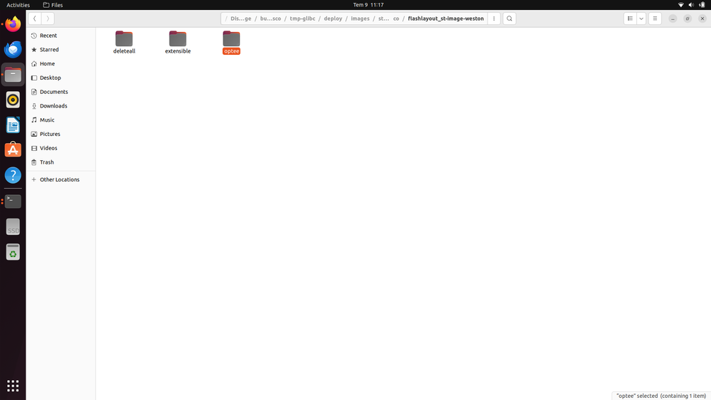

nesnesAuthor
July 9, 2024

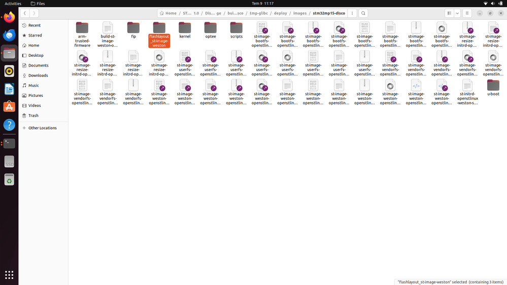

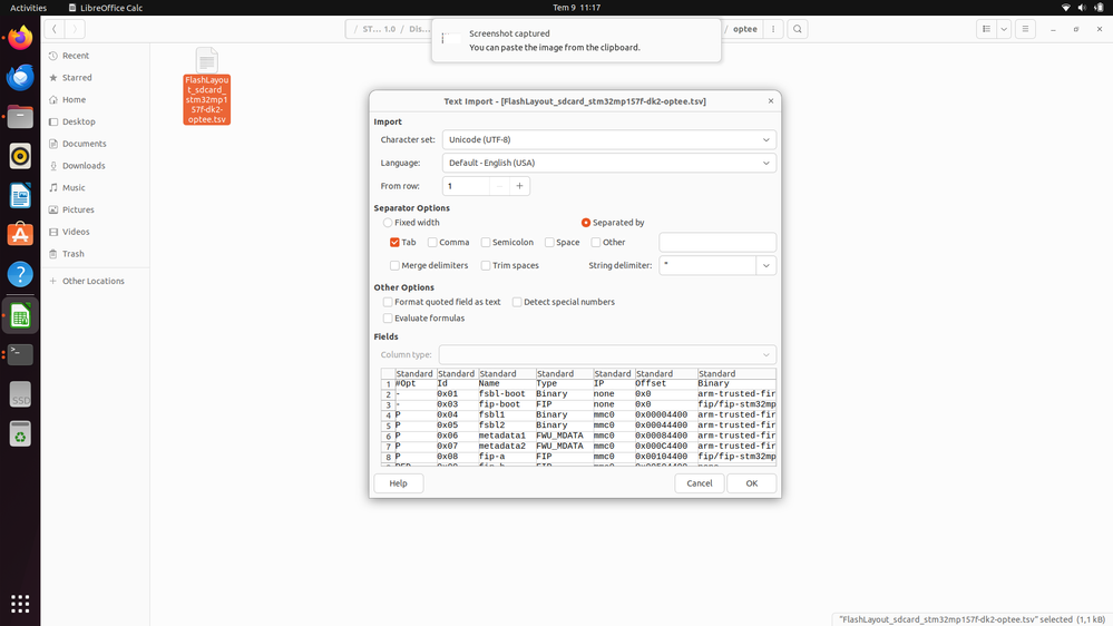

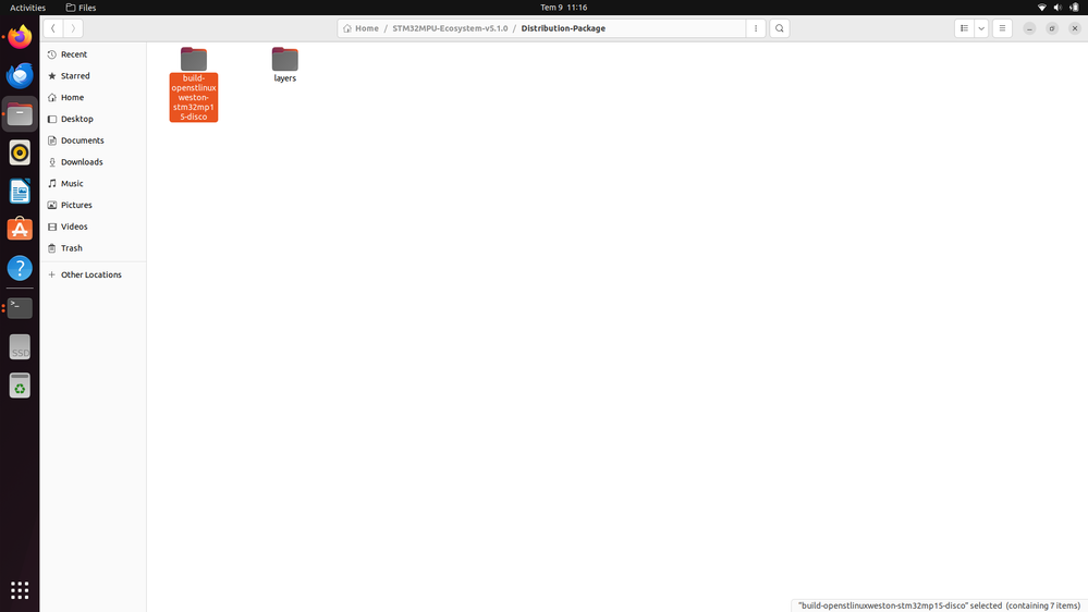

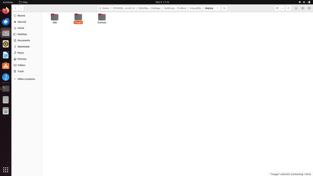

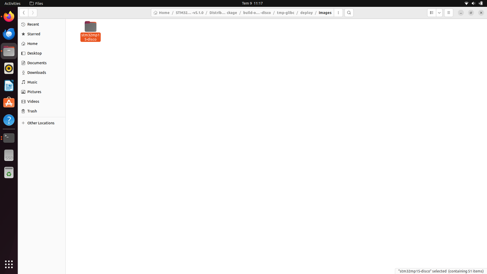

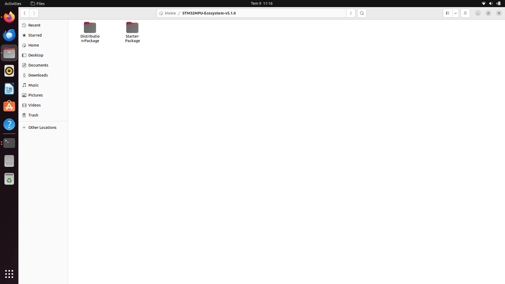

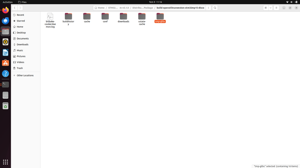

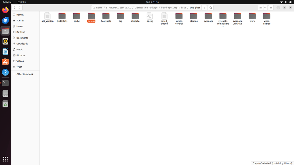

In distribution package the .tsv folder is in the the
~/STM32MPU-Ecosystem-v5.1.0/Distribution-Package/build-openstlinuxweston-stm32mp15-disco/tmp-glibc/deploy/images/stm32mp15-disco/flashlayout_st-image-weston/optee$
direction . I already did the starter package and flash image now I am doing distribution package. I have followed the recommended directory Screenshot from 2024-07-09 11-19-56.png
