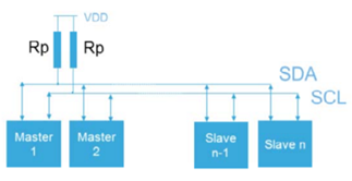

1.1 Signal integrity
The I2C IO pins must be configured as open drain mode. The logic high level is driven by external pull-up resistor.
Typical value of I2C pull-up resistors (from practice) is
between 2.2kOhm up to 10kOhm whereas customers implemented 100kOhm observing the wrong I2C bus timing. Internal pull-up resistor typical value is 40kOhm so
external one must be populated.
The timing of I2C must be in line with I2C specification. You should
measure and check the signal integrity on the bus.
![115.png 115.png](/t5/image/serverpage/image-id/214i9410128287A2BF57/image-size/large?v=v2&px=999)
(Figure 1: Pull-ups on I2C bus)
