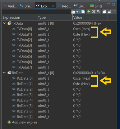

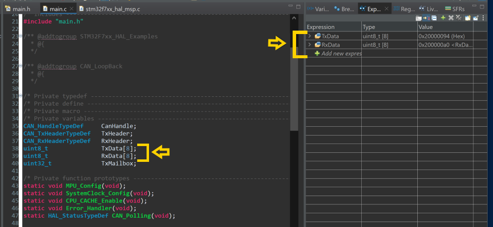

7. Run the example project
To run the example project, first launch a debug session by clicking the [Debug] 5v3.jpg icon.
Now, add the CAN2 TxData and RxData variables to the STM32CubeIDE "Expressions" tab so we can see the CAN2 data after it is transmitted.
Run the application by clicking the Run/Resume icon. After a few seconds, click the Pause icon to pause execution of the application so we can view the values of the CAN2 TxData and RxData variables.
Now when we inspect the CAN2 TxData and RxData, we can see that the values ‘0xCA 0xFE‘ were transmitted, and the same ‘0xCA 0xFE‘ values were received. This indicates that the example is working properly on the STM32F769I-DISCO board when using CAN2.
