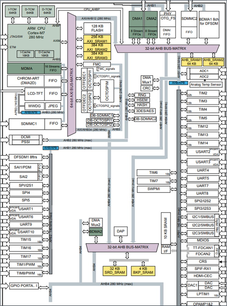

 Timer connections with APB differ from one product to another, however, the information is always detailed in the product datasheet, typically within the block diagram. In this section, we focus on the STM32H7 series.
This is the STM32H7B0xB block diagram, showcasing different timer connections:
  • TIM1 and TIM8 (advanced timers) are connected to APB2.
  • TIM15, TIM16, and TIM17 are also connected to APB2.
  • All other timers, including general-purpose and basic timers, are connected to APB1.
This bus allocation impacts the timers’ clock sources and their maximum operating frequencies, which are critical for designing precise timing and control applications.

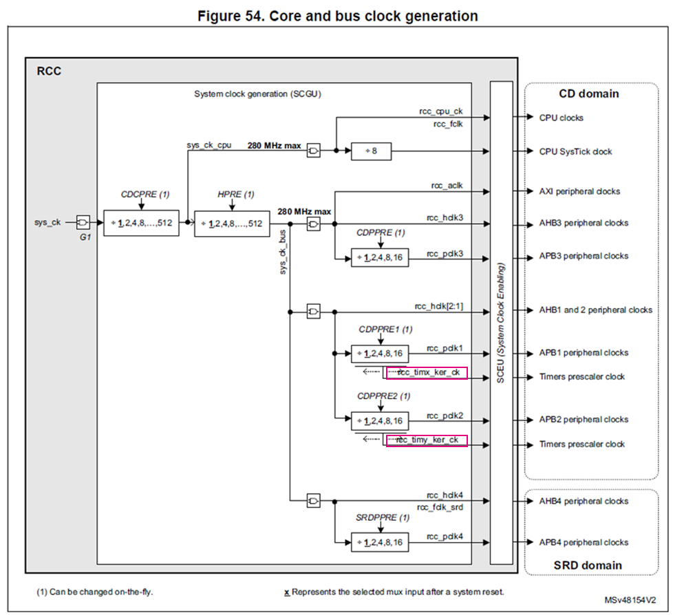

The following figure shows a simplified view of the clock distribution for the CPU and busses:
This table is taken from RM0455This table is taken from RM0455
This block provides the clock for the timers (rcc_timx_ker_ck and rcc_timy_ker_ck). The frequency of the timers clock depends on the APB prescaler corresponding to the bus to which the timer is connected, and on the TIMPRE bit.

*CDPPRE1 and CDPPRE2 belong to RCC CPU domain clock configuration register 2 (RCC_CDCFGR2).
**TIMPRE belongs to RCC clock configuration register (RCC_CFGR).
